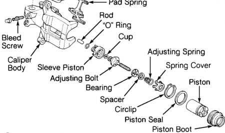

    I just could not put enough pressure on the end of the piston... The tool I bought did not fit properly - but I could wangle it so that it pushed against the piston, and hen I turned the piston with a pair of pipe grips! Once started, it was a lot easier and I could use just the needle-nose pliers and hand pressure. I found the following...
    QUOTE
    The adjuster inside is threaded, as the piston moves out the adjuster turns. To 'unadjust', as you can't reach the adjuster, you turn the piston. The pressure the tool puts on the caliper holds the threaded adjuster still allowing the caliper to wind around it and go back into the caliper body.
    Have a look below at a typical rear caliper:
    UNQUOTE
    https://www.2carpros.com/forum/automotive_pictures/62217_cal2_1.jpg
