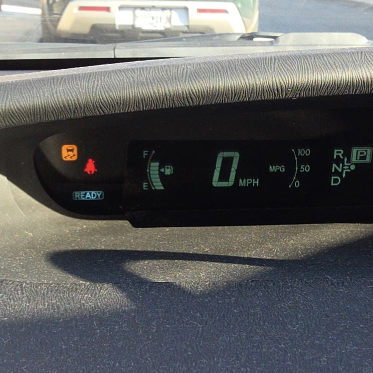

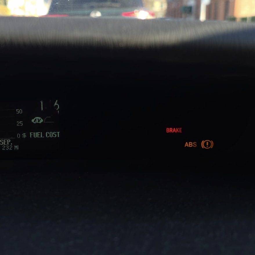

    When we went to pick it up the mechanic said the car has computer problems also and we saw the dash was lit up. He say his upscale computer isn’t resetting it.

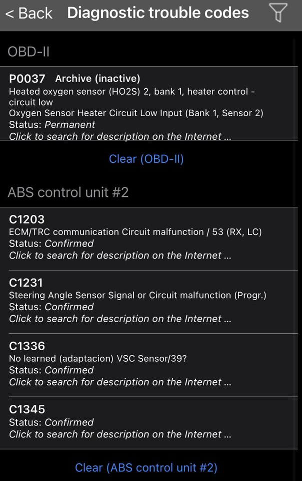

    I attached a pic but It’s ABS light, brake light, traction control, and some others. The codes are C1203, C1232, C1336, C1345.

    Well he needs clear out info for brake parts it looks like according to some scan pics . I would imagine till that happens you locked out of brakes as far as the finished repair. So it's like mostly completed ? Two brake parts in this model they both talk to car with wires or such . Only 1 piece replaced?

    I did . But you have brake codes now . Ripping out the 02 wires is a stretch to get to brake codes .do you now probably have issue with brakes on a gen3 .unless the cat steal involved ripping out a wheel sensor wire . But that 1365 or 4 won't come for that . Sooóo I didn't lok at other codes . On that list . Those 2 usually all I need . Unless 12V isn't but that would've been mentioned. Charge 12V secure all connections delete codes . What returns 1365 or 4 . And welp .
