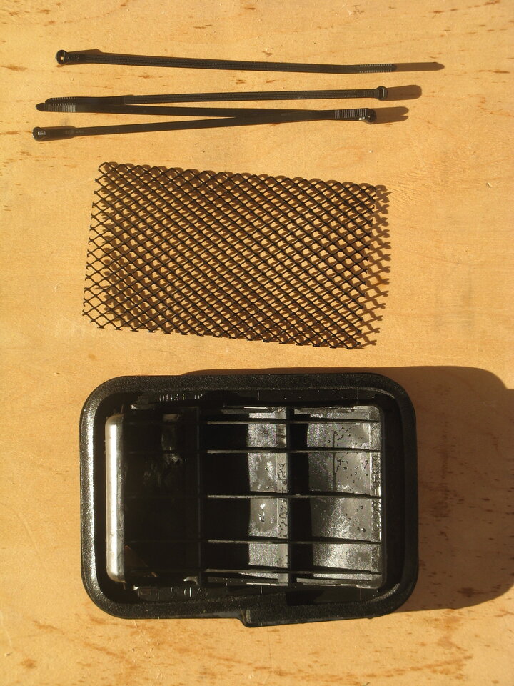

  7. Georgina Rudkus
    Georgina Rudkus Senior Member
    Sep 15, 2018
    3,560
    2,599
    Taylors, SC
    1. Remove the engine cover. This improves engine cooling and provides no place for a rat's nest.
    2. Add screens to likely entry points using steel mesh or 1/4 inch opening hardware cloth.
    - Add a screen over the intake air filter to prevent the rodent from chewing through to clog the intake.
    -Cut a 2 inch strip of hardware cloth and roll it up. Shove it into the intake snorkel.
    -Get a cabin air filter that has a built in screen. K&N reusable filter have a steel mesh screen that will prevent chew through.
    -Remove the plastic rear flow through air exit vents accessible under the rear side panels. They will pry out from the outside.
    Install screens and reinstall. A photo is attached.
    3. Rodent repellent.
    1. Cover all wiring and all surfaces in the engine compartment with a light petroleum based rustproofing aerosol spray. Rodents
    will not chew on soy based wire insulation covered with petroleum oil based wax.
    2. Spray peppermint oil and red pepper based rodent repellent over the petroleum based rustproofing.
    3. Lock in the rodent repellent with a light overcoat of petroleum based rustproofing.
