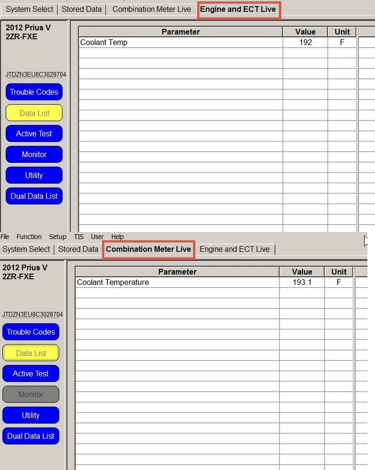

    3. What are the two coolant temperatures reading normally and when the light comes on?

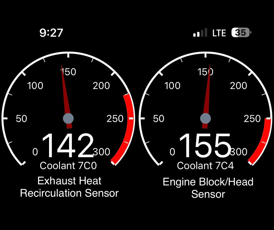

    Both radiator fans should run anytime the ac is on with the car not moving. However at speed they are not needed so they are unlikely the cause at high speed.
    A properly functioning cooling system should never hit 220f and will normally run 200f or less even at highway speeds in 100f ambients. Knowing the temperatures goes a long way to diagnosis.
    The warning light comes on at 248f so there is an issue.
    There have been cases where the temp sensor on the engine is ok while the temp sensor on the return hose of the exhaust heat recirc system is pegged high.
    Techstream's sensors are both called Coolant Temperature. The Car Scanner app with bluetooth uses Coolant 7C0 and Coolant 7C4 designators. The second and third lines of descriptions on the pic were manually added for clarity.

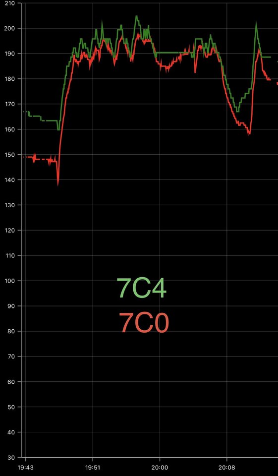

    Normals
    Techstream
    Car Scanner app

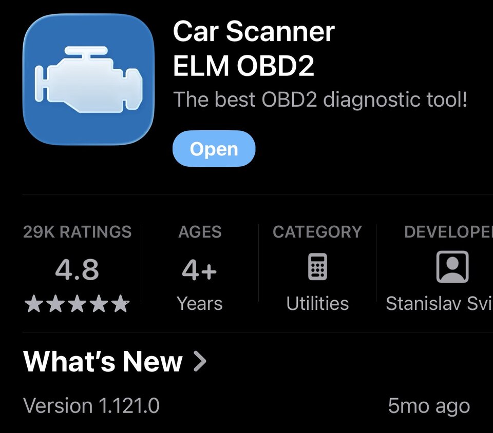

    rjparker, is the "Car Scanner" app you mention the one found in app stores called "Car Scanner ELM OBD2" offered by Stanislav Svistunov?
  6. rjparker
    rjparker Tu Humilde Sirviente
    Jun 6, 2008
    11,096
    6,962
    Texas Hill Country
