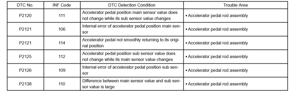

    I've already posted it, but here is the schematic again
    Here are possible accelerator pedal sensor DTC's
