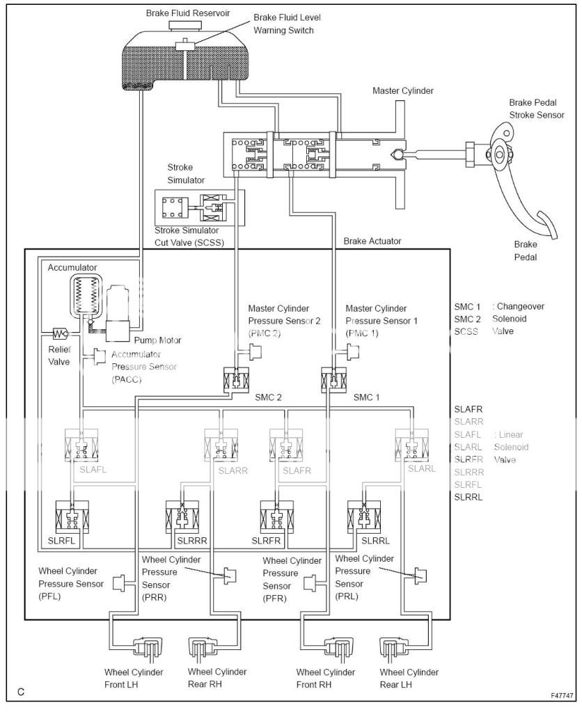

  14. jayman
    jayman Senior Member
    Oct 21, 2004
    13,439
    641
    Winnipeg Manitoba
    The car will "simulate" brake pedal feel, while using the M/G in reverse, like a generator. Once a wheel loses traction while braking, engaging the ABS, the regenerative braking is dumped and normal brakes are used, which results in a momentary loss of braking

  16. dogfriend
    Feb 26, 2007
    7,512
    1,191
    Carmichael, CA
    The Prius will use regenerative braking whenever possible to try to recover some of the energy that is lost when braking. In regenerative braking, MG2 (attached directly to the wheels) acts as a generator and provides resistance to turning the wheels while generating electricity that can be stored in the battery. The Skid Control ECU communicates with the HV ECU and Battery ECU to determine how much regen braking is available and will add friction braking if necessary to slow /stop the car. Below approx 7 mph, regen does not work anymore, and the braking switches to friction only.
