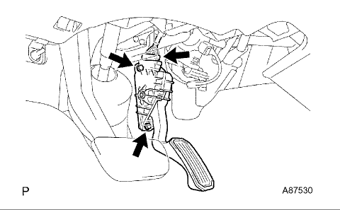

    I had one NHW11 Prius that came in for refurbishment with a problem:
    Notice that in this 2001-03 accelerator, the nylon cam follower was actually jamming in the "U" channel slide. It would not freeze but I could feel a mechanical 'spot.'
    This out-of-focus photo more clearly shows the problem:
    I really didn't see it until I was looking at the resistance curves:
    What I've never seen is the internal structure of the NHW20 accelerator assembly. I don't know if a similar 'cam-follower' mechanism is used or something that does not involve additional moving parts.

    You wouldn't have to touch the gas pedal. If there is an internal problem with the sensor, as Bob pointed out with the bad Gen I pedal assembly, just normal road vibration could cause a change in resistance values.

    A very plausible theory. I would not be surprised if a similar structure is used for the Gen II. We need somebody to confirm this. Eg a similar throttle body is used for the Gen II

    The accelerator pedal assembly could have an internal problem, as Mr Wilson documented on that Gen I pedal assembly. There could be a wiring problem between the pedal and the ECU (Chaffed wires, momentary short or open, etc)
