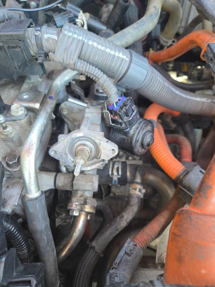

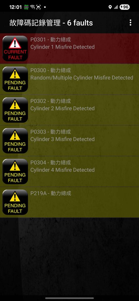

  4. wukong sun
    wukong sun Junior Member
    Apr 23, 2025
    66
    95050
    Ignition coil and spark plugs were replaced
    Injectors were all repositioned
    EGR system, valves, coolers, intake manifolds were cleaned
    Unplugged EGR and tested, no change
    Removed EGR valve solenoid
    Press manually and the engine speed will drop immediately
    It becomes rough. Press again, the engine is almost shut down
    Release hand and it will return to normal
    The fault still exists
    Only the circuit has not been checked
    Leaving overnight, cold start does not shake
    Battery level 2, it shakes when charging
    Shakes at 15-40 mph
    No shaking can be felt at 40-70 mph on highway

  6. wukong sun
    Apr 23, 2025
    66
    95050
    Unplugging the EGR power plug
    It's like using a shovel to block the EGR pipe
    There's already a post
    Many people unplug the EGR power
    I took down the entire electromagnetic part
    Manual test, smooth in and out
    EGR valve closed by default, normal idle
    Press it down to reduce the speed
    Press it again and the engine will almost shut down
    There are many roads to Rome

  8. wukong sun
    Apr 23, 2025
    66
    95050
    I removed the electromagnetic part of the black housing of the EGR valve.
    Keep the power plug on the EGR.
    Press the valve manually, and it goes in and out smoothly.
    Start the engine in maintenance mode.
    The EGR valve is closed by default, and the idle speed is normal.
    Press the valve slightly, and the speed will decrease.
    Press the valve again, and the operation is rough.
    Press the valve again, and the engine is about to stall.
    Release your hand and it will return to normal.

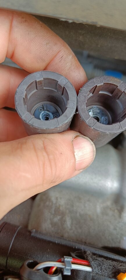

  9. ChapmanF
    28,753
    19,060
    While you have that electromagnetic part removed, which example here does it look like on the inside?
    (The difference is in the little "ski jump" part down inside. The one on the right has a rut worn through it.)
    #29 ChapmanF, May 20, 2025
    wukong sun and Brian1954 like this.

  11. wukong sun
    Apr 23, 2025
    66
    95050
    Maybe it's more like the one on the right. I just look at the glue. There's no difference in other aspects?

  13. ChapmanF
    28,753
    19,060
    If there is a rut through that stop, it's no good. The valve won't actuate accurately.

  14. Mendel Leisk
    61,603
    42,378
    Too bad you can’t just replace that bucket.
    I had it in my hands last time around, but was mainly focused on cleaning. It’s cast metal, rotates in there due to surrounding electromagnetic field?
  15. ChapmanF
    28,753
    19,060
    I've never figured it for cast metal. seems more like some sort of thermoplastic resin, but magnetized, so probably containing metal particles or something. Like those plasticky bendable fridge magnets.
    It's a stepper motor rotor. It has some number of magnetic poles (another poster said 12 pairs, I guess if you put some paper over it and scattered iron filings you could count them), and the stator has electromagnet windings magnetically linked to the metal fingers (48 of 'em?) you see inside the stator. Each time the ECM switches the magnetic field direction between the fingers, the rotor makes one little step around to align with the new fields.
    wukong sun and Mendel Leisk like this.

  17. wukong sun
    Apr 23, 2025
    66
    95050
    I took it apart and looked carefully, and then I found the ski jump.
    I was really careless.
