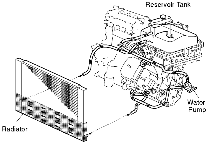

    Did you look at the link that I gave you? It has the flow diagram. System looks complicated in a Prius as it’s hard to see how everything is routed as the engine cooling loop is in the same area.
    Your Prius having different inverter cooling loop is very unlikely. From your describing it sounds like the hose that goes from radiator to inverter is switched with hose that goes from reservoir to pump. But system is very hard to see so it’s easy to get mixed up.
    Remove the hose going from reservoir to pump. Then just look that there’s no restriction in the reservoir and that the hose wasn’t kinked.

    This is from valde3's reference:
    It agrees with my parts diagram, and there is clearly a gravity connection from the front of the reservoir to the suction of the pump. (You can also see the hard connection from the inverter to the reservoir.) The reservoir should immediately drain when the hoses are disconnected at the pump.
    I agree the hose from radiator to inverter could be swapped with the hose from reservoir to pump. That's the only scenario that makes any sense.
    You should be getting close to three quarts into the loop.

    Bingo. Indeed those two lines are reversed. Funny because I was looking at the flow diagram in my Bentley manual and according to it, it's correct . but if you are sure your diagram is the correct one I will swap them amd see what happens. The pump inlet hose is not going to the hose on reservoir, it is going straight to a port on upper inverter! I always checked the level in reservoir for the 50 k miles I have had it. So this error was made by some mechanic within first 50k miles. Unless the factory did it? I guess there must be considerable cooling even if it's not circulating!
