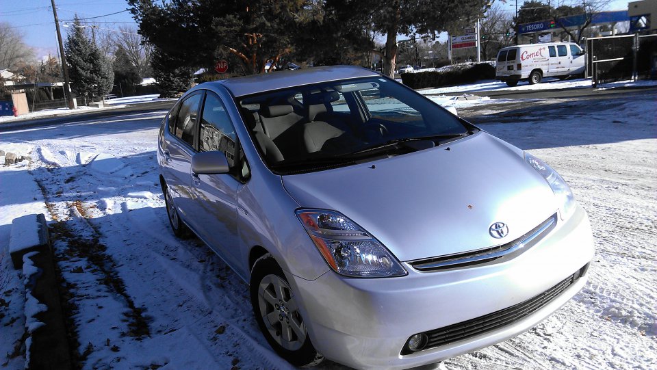

    Nice looking Prius. Looks like the 15" wheels and covers to me, probably not a Touring. But does have the fog lights, which pretty much means the HID upgrade on the headlights.

    Thank you very much. We drove it quite a bit today before we went to the bank and signed. It drives really well and the battery shows constant 80% up or down a line or two. Yes they are 15 inch and the spoiler looks stock to me.
    I drove it a bit in the snow and is very stable. I actually talked to other owners before I bought mine, and they said its really good in snow also. The bad is the low clearance of the car in thick snow.

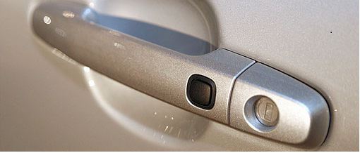

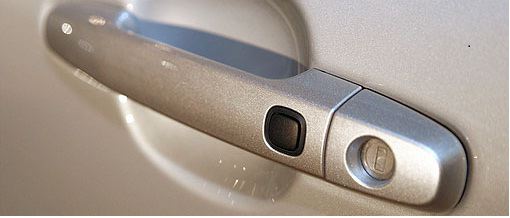

    Also, does your Prius have the black square button as shown below on the front door handles?

    yes is does and it has one on the back hatch also........I will try it and get back to you

    Ok, that tells me the car has the SKS system on it.
    Try pushing the button I described. Then let me know if the Prius will enter Ready Mode without the key in the slot. The key needs to be inside the Prius when you try to enter Ready Mode. I am referring to the button on the bottom of the steering column. I will explain the square button later...

    When you go up to the car, touch the inside of the front door handle. The door will unlock for you. Note: Drivers door, only drivers door unlocks. Passenger Front Door, all doors unlock when touching the inside of the handle.
    Once inside the car, close the door. Foot firmly on brake pedal, then push the Power button one time. Ready should appear on dash.
    Drive off when ready. Don't forget, the transaxle will only shift out of P when you have your foot on the brake. And also don't forget to push "P" on the dash when you want to put the transaxle into park.
    When you park, power down by pushing the Power Button again. No need for foot on brake.
    Exit the car, close all doors, and then push the square button on the door handle or the rear hatch. All of the doors should lock.
    I only shared this since I said I would explain the square black button later.
