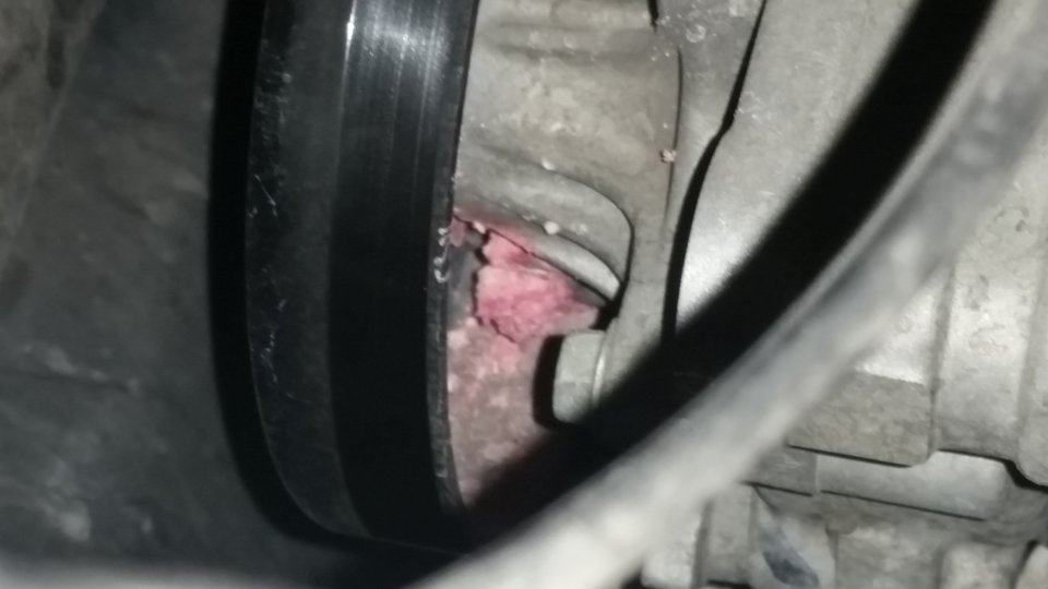

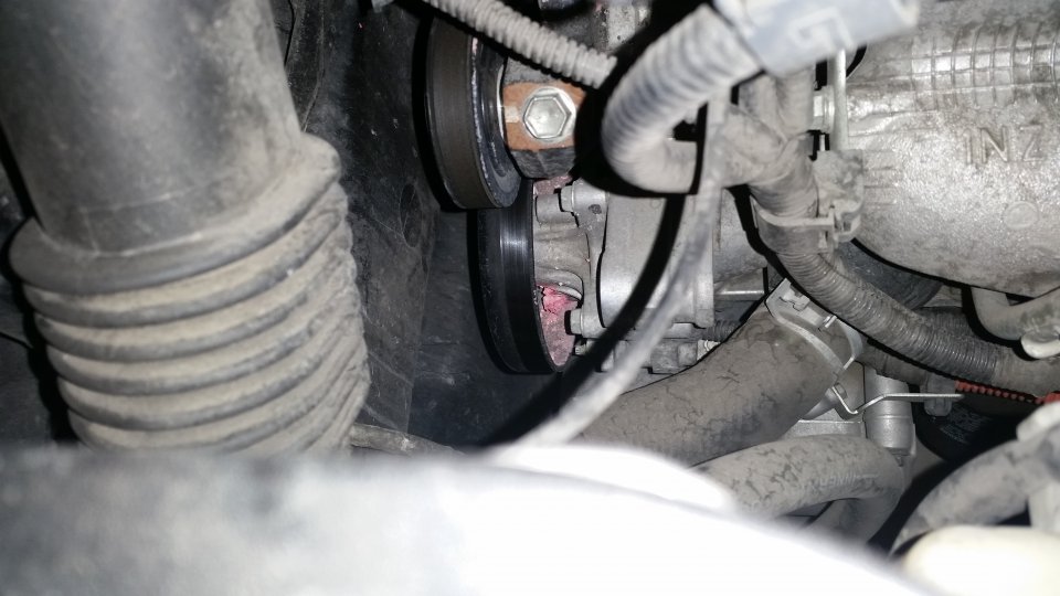

    Hello all,
    I was checking the mileage i wrote on my air filter and was checking to see if my belt is still in good shape (recently replaced) and it let me to a interesting discovery, and 3 questions.
    In the pictures below, what component is leaking, and what is it leaking?
    Does the prius only have 1 belt that needs replacing, that runs all components?

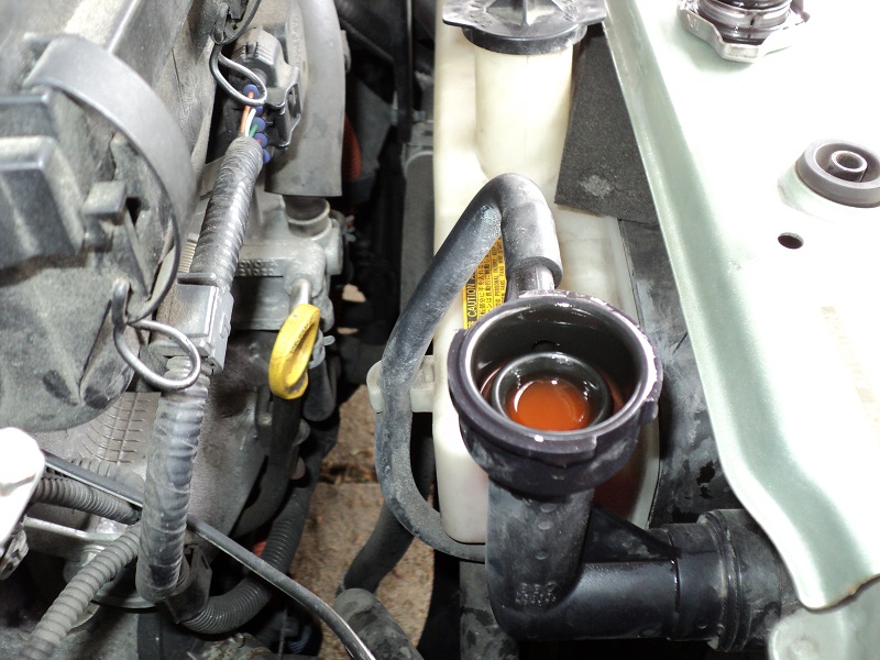

    Water pump is leaking. Typical of the Gen II. Ours did it too. Probably have a little stripe underneath the hood on the insulation also which looks like it runs from the front of the car towards the windshield. Get the water pump changed, and have the coolant replenished and or replaced. Don't forget to bleed the system to get the air out.
    Don't be surprised if the overflow bottle is still full. A lot of times the radiator will be low, but the bottle be full. Remove the splash guard over the radiator and check the fluid level under the cap when the ICE is cold. Should look like the picture below when it is full.

    1. The engine coolant pump is leaking pink Toyota Super Long Life Coolant, and that should be replaced now.
    2. Yes, the serpentine drive belt drives the engine coolant pump. That is the only accessory which is mechanically driven.
