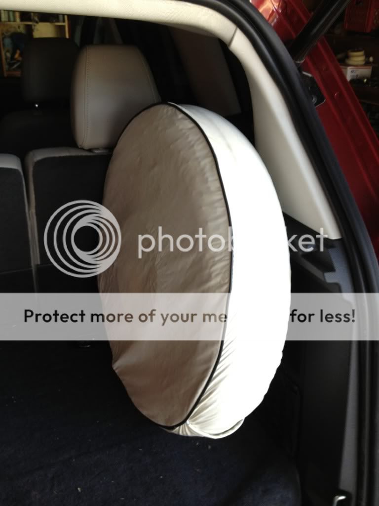

    I bought this very inexpensive cover from Amazon to, umm, cover mine while carrying it in the car:
    Camco 45359 RV Vinyl Spare Tire Cover (21-1/2" Diameter, Beige)
    cost about $10 shipped with amazon prime.
