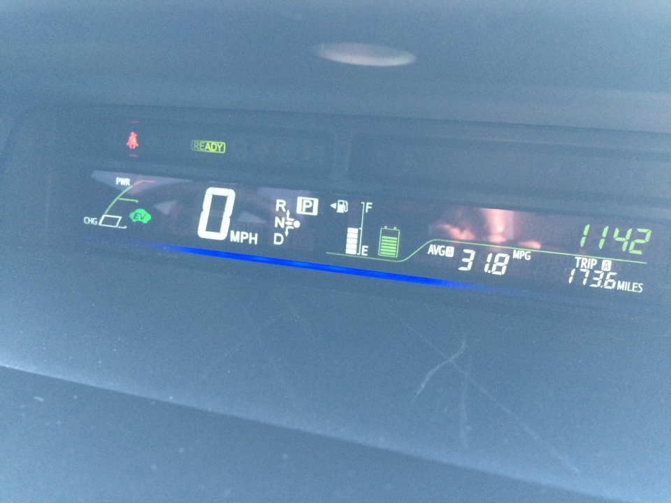

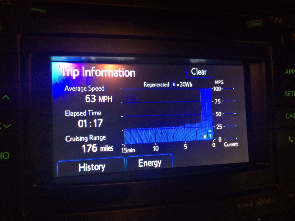

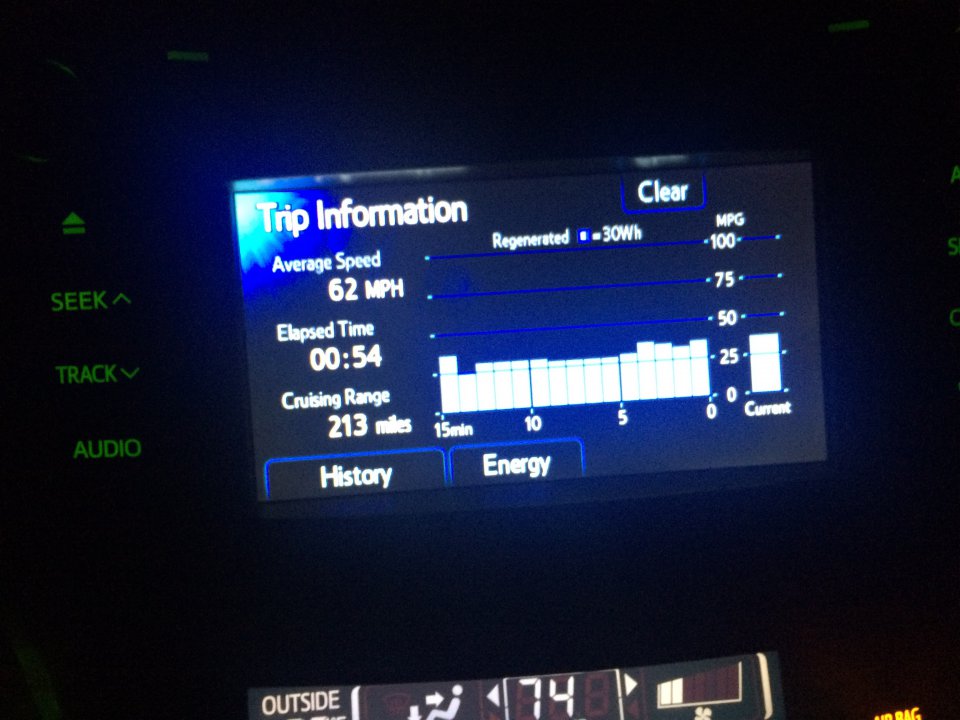

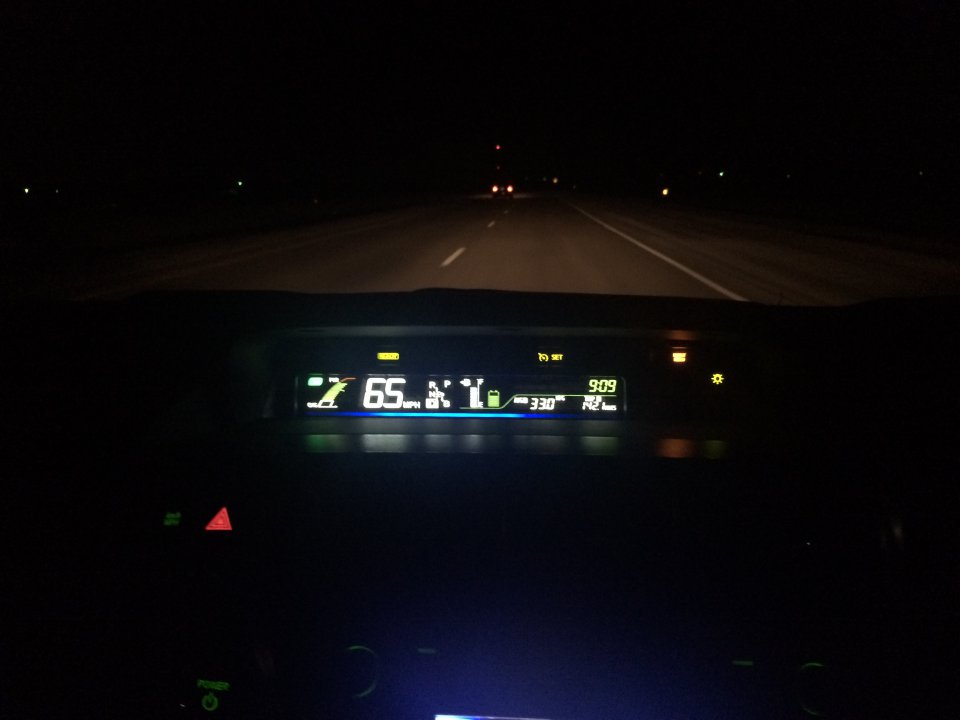

    image.jpg This trip was all taken in the Mississippi River valley between Memphis and Jonesboro, Arkansas night before last. It was fairly windy but also some of the flattest road s I have travelled.
    image.jpg image.jpg When I turned off the car at the end of the night. These were the readings.
