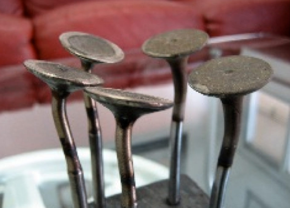

    Do you mean timing chain? if so it makes sense if the valves are bent or broken, driving another 40 miles did not help at all. Almost every insurance company offers free towing.
    The main reason for the miss-fires could be bent valves or hopefully just miss-timed:
    But you said "drive belt" are we talking about the aux/fan belt? Well, if water pump is not pumping that will certainly over heat the engine blow head gasket.
