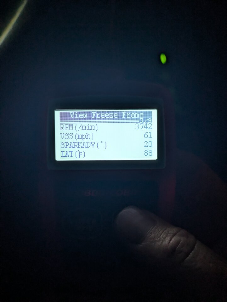

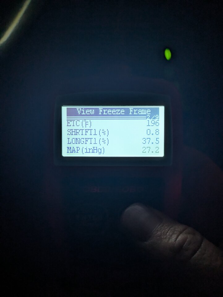

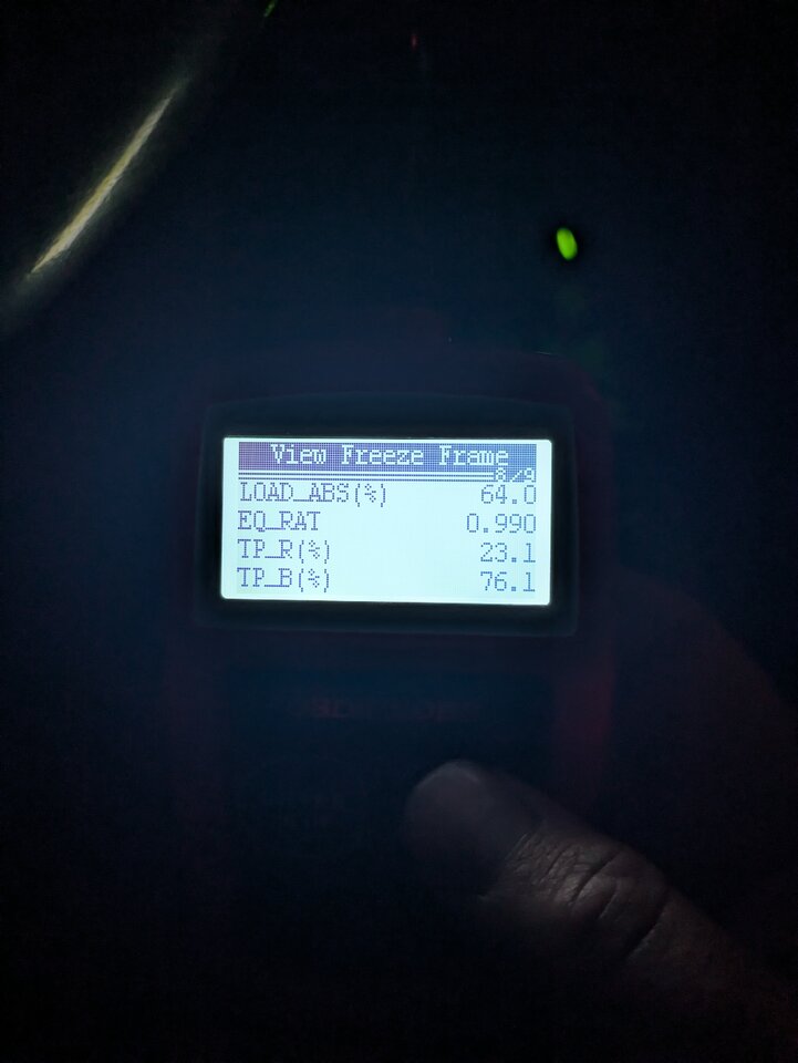

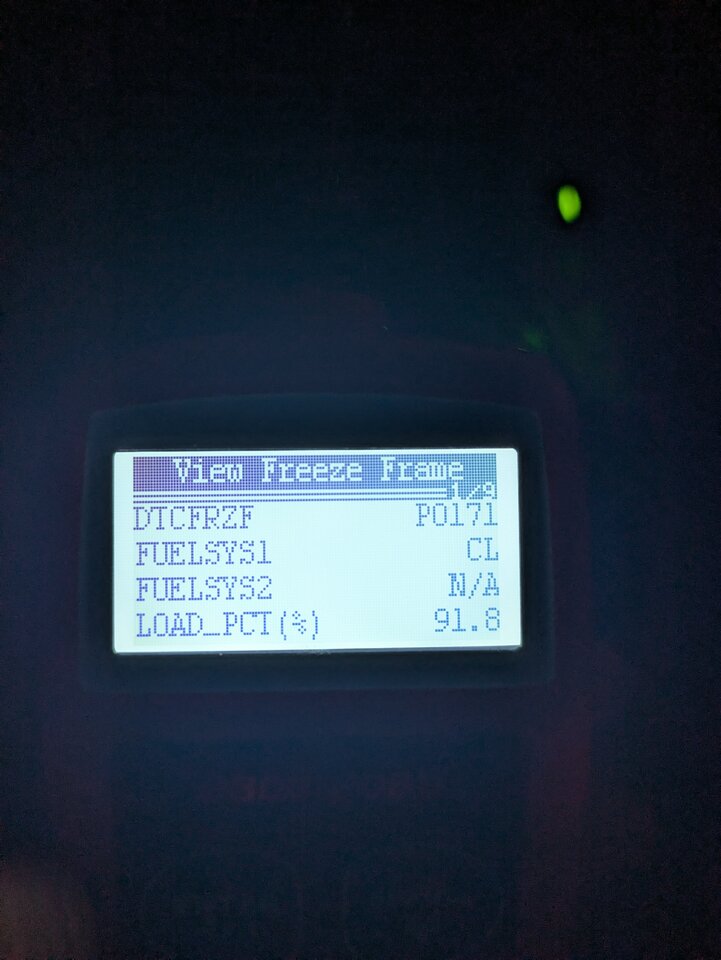

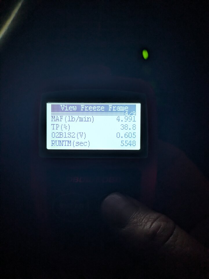

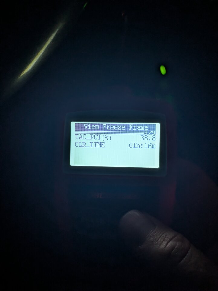

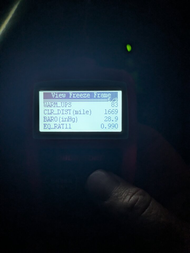

    Finally generated first CEL with code p0171 while driving uphill on freeway. All freezeframe data appears “normal” or as expected for a lean condition, save for EGR% at 65% (will include photos of freeze frame data below). Did a “cheap vacuum leak check” (can of spray carb cleaner), found no notable change in RPM despite near saturating of all connections between MAF and throttle body, around intake manifold, spark plugs, EGR valve/cooler/pipe, PCV valve. Confirmed RPM would surge when cleaner was directly sprayed into air intake. Disassembled ERG valve and performed cleaning in case plunger rod/spring was sticking, found expected carbon build up but no where near complete blockage (approx. less than 1mm around walls of EGR connection pipe). No improvement after cleaning, reassembly, and second vacuum leak check. Current LTFT 23%, STFT still “jumpy.”
    I suspect a failing fuel pump/clogged fuel filter/clogged regulator, as all parts are original and the tar glue around the pump cover appears intact with no evidence of scrapping. However, before doing a fuel pressure test, and replacing the entire assembly unit, I want to make sure I am not overlooking anything besides the usual suspects: O2 Sensors, MAF sensor, EGR, Injectors, Vacuum leaks, etc. Essentially “check my homework” please.
    *CEL freezeframes:
    PXL_20251012_032830750.MP.jpg PXL_20251012_032839608.MP.jpg PXL_20251012_032842402.jpg PXL_20251012_032844736.MP.jpg PXL_20251012_032847007.MP.jpg PXL_20251012_032849177.MP.jpg PXL_20251012_032851331.jpg PXL_20251012_032853400.MP.jpg PXL_20251012_032855460.MP.jpg

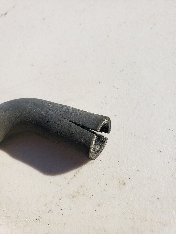

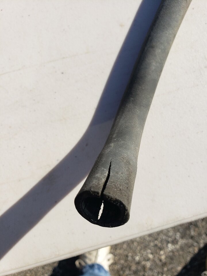

    The freeze frame data for the long-term fuel trim is showing 37.5%. I am guessing that you have a vacuum leak in a hose. The most probable place is the hose that runs from the intake manifold near the throttle body over to the purge valve. The hose on the other side of the purge valve probably also has cracks in it where it attaches to the purge valve. Take the air box off and take a look at those two hoses.
    I replaced those two hoses on my niece's 2010 Prius early this year. Her car also had the P0171 code. I also checked my 2011 Prius and the same two hoses.had just started to develop cracks, but it was not bad enough to trigger the code yet. I believe this is a common problem for a 15 year old Prius.
    Here are pictures of both ends of one of the hoses that I replaced on the 2010 car.
