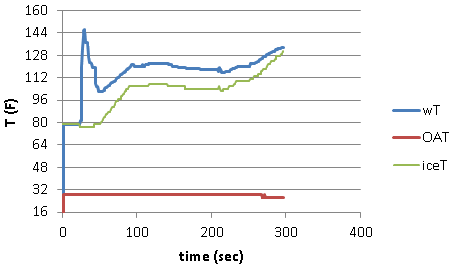

  17. 2009Prius
    2009Prius A Wimpy DIYer
    Mar 25, 2009
    2,705
    512
    63
    Re: etf vs. FWT?
    Yes there are two different temperatures reported by passive CAN IDs and the engine coolant temperature reported by standard OBD message requests can be different from both of them - it may be some intelligent combination of the two "raw" measurements.
    See graph below for a short record of the two temperature readings:
    The graph shows in the beginning of the drive the coolant T (wT) rose quickly due to the hot fluid from the thermos but also fell back down soon after the ICE starts and mixing cold fluid from other part of the system. On the other hand the temperature of the ICE (iceT) just rose up slowly. So we can be quite certain that one sensor (wT) is in good thermal contact with the coolant while the other (iceT) with the engine block. But I don't know where exactly they sit.
    In the beginning of the drive the standard OBD reported coolant T reads close to wT, but after things all warmed up, wT would shoot up higher than iceT, and the standard OBD reported coolant T now reads closer to iceT. I haven't figured out what algorithm the Prius computer uses to combine wT and iceT to generate the OBD reported coolant T.
    Now I think of it, since the iceT presumably won't be affected by air bubbles due to its intimate contact with the engine block and Prius "thinks" the coolant T being iceT once things all warmed up, there is less a chance of missing the event of air bubbles causing engine overheat as we were considering earlier. That thought gave me some piece of mind. :)
