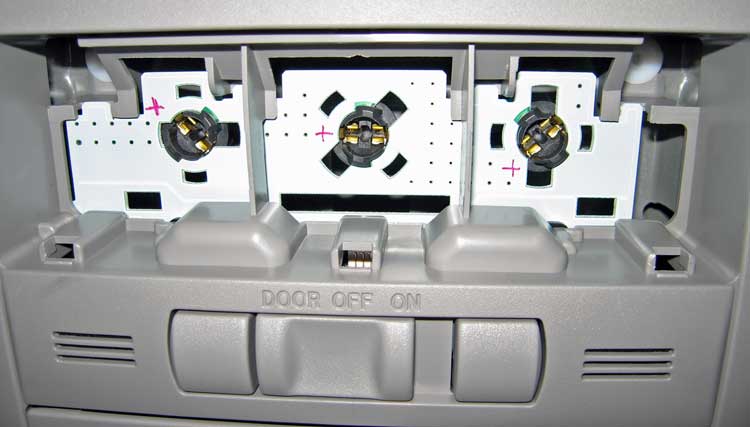

    The front dome circuit board, which contains the map and dome bulbs, is cracked. I tried to replace a bulb and put too much pressure on the center location, causing a crack in the circuit board.
    Does anyone know the part number and where I can buy a new front circuit board.
    Here is a picture for reference. (borrowing pic from evnut)

    This site doesn't show a separate part number for just the board. The whole assembly is $131 or $301 depending on whether it has the NAV microphone or JBL.
    81260‑47010‑A0 NHW20; IVORY, TRIM0* 1 $131.53
    81260‑47010‑B0 NHW20; GRAY, TRIM1* 1 $131.53
    81260‑47010‑E0 NHW20; GREGE, TRIM4* 1 $131.18
    81260‑47030‑A0 NHW20..USA; EMV(W/NAVIGATION SYSTEM)-WITH, IVORY, TRIM0* 1 $301.18
    81260‑47030‑B0 NHW20..USA; EMV(W/NAVIGATION SYSTEM)-WITH, GRAY, TRIM1* 1 $301.18
    81260‑47031‑B0 NHW20; AUDIO-05AM/FM+CD-CHANGER JBL 9 SPEAKER, GRAY, TRIM1* 1 $301.18
    81260‑47031‑E0 NHW20; AUDIO-05AM/FM+CD-CHANGER JBL 9 SPEAKER, GREGE, TRIM4* 1 $301.18

    I decided I will try to have someone solder jumper wires on the board to see if that works. I did not have any luck locating a salvage yard with a prius.
    Thanks again.
