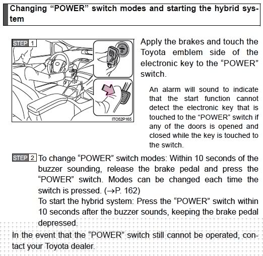

    I thought if the key fob battery was dead you could still start the car holding the key fob by the power button? You still have to push the power button, right?

  9. RRxing
    RRxing Senior Member
    Jul 7, 2009
    2,559
    1,833
    NEPA
    Correct.
  10. paprius4030
    paprius4030 My first Prius
    Aug 12, 2004
    2,077
    296
    York,Pa.
    Thanks I thought this was so. It seems a little complicated though when you are upset or rattled when your car won't start normally though. It's just when something goes wrong you just have to remember to calm down and stay cool and whip out the owners manual to see how to solve your problem.
