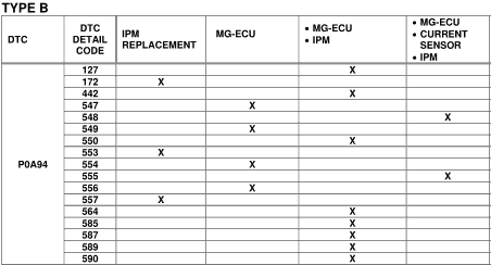

    And I have the Prius back. Indeed it was the J0V recall. The symptoms were that the Prius went into "limp mode" and only ran on the gas engine while I was heading back home after the problem manifested. The following lights were illuminated and that was followed by a dead 12V battery, sending me on a wild goose chase as to the cause of my problems:
    The following warning lights all came on immediately after turning on the adaptive cruise control (see attached photo)l:
    Slip Indicator light
    Dynamic radar cruise control
    Brake System Warning Light
    Malfunction Indicator Lamp (Engine Check)
    Hybrid System Warning Light
    Pre-Collision System Warning Light
    E3 displayed in the dash
    I guess the Hybrid battery charges the 12V and when the system stopped functioning, so did the 12V charging.
    I pressed for Toyota to pay for the towing, and for a replacement rental car. After some hagglin, I was successful. Attached is a photo of the work they did.
    Thanks everyone for your help.

  15. Mendel Leisk
    61,533
    42,345
    So what was it happened, in laymen's language? The "IPM" was replaced. This is a small computer inside the inverter case?
  16. ChapmanF
    28,721
    19,020
    You can look back at post #36 for an overview of what bits in the inverter assembly get replaced, depending on the details of the failure in any specific case. As the work order shows the detail codes were 553/557, only the IPM was replaced. It's a box of honkin' transistors with some control circuitry.
