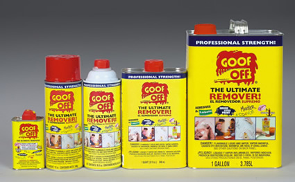

    Hi M; I have been dealing with pine tree sap for years.
    The sooner you get to it the easier it will be to remove. The older the sap the drier it becomes, but it's still can be dealt with effectively.
    Clean the area around the sap first. Use "Goof Off" (bought at Home Depot, Ace, or any H/W store) soaked on a paper towel and place that on the sap. If the sap is still fluid and sticky, the Goof Off will remove it very easily. If dried, just keep applying the Goof Off and rub it gently and it will come off as it loosens up. No need to rub it too vigorously.
    Once removed, clean the area again or better yet just wash the car and I like to wax that specific area.
    Good luck!

    In addition to Goof Off, Bug and Tar remover, available at all the car stores, works well. If it's fresh (like same day), the high pressure wand at a car wash will take most of it off, reducing some labor.

    I would first try warm, maybe very warm water and car wash soap, it that doesn't do it and you can tell with your fingers, if it's gone, I would then go with a clay bar. I would not use Goof Off or any other petroleum derivative as I would be concerned with long term damage to the clear coat. There is no doubt the petroleum products will do the trick, but the long term effects could be noticable, especially if the car will be in the sun.
