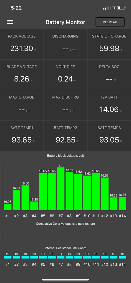

    Pulled Dr Prius battery scan and included the screenshots (not sure how to interpret exactly, but what I saw online seemed to indicate that means the battery is still healthy.

    Because that's a problem with a particular voltage-monitoring circuit, it may not indicate any reason to replace the whole battery at all, as opposed to just finding and fixing the problem in the monitoring circuit.

    That module has a mess of skinny wires (the No. 2 Frame Wire) plugged into it and connecting to 14 different monitoring points across the battery (every second module). Either some of those skinny wires will look ugly or broken off (the third one, in fact, according to the code you've got, but if you're in there and looking, may as well look at them all), or the socket where they plug into the module will have pins that look ugly or broken off (replacing module fixes that), or both. It's not likely to be something too hard to see.
