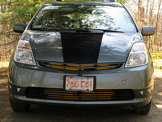

    Okay, I need some aesthetic feedback here. Maybe it's that I
    keep hearing the rods going by on the highway a half-mile away
    [gas prices, schmas prices...] or that I just spotted a lot of
    sensible "line matches" when staring at the car's nose.
    Note that I haven't actually *done* this to my car yet, it's just
    a photochop artist's conception. But somehow it brings to mind
    those raised-center mustang or whatever hoods, y'know, the one
    you squeeze the massive blower underneath. Or something. I'm
    kinda likin' this, and I'm not even sure it would hide the fact
    that there's a bump where the logo was...
    Comments? Counter-proposals? This feels particularly weird
    because I usually don't sit around art-fagging about cars.
    Then again, if there wasn't something going on here I wouldn't
    have pulled the logo off in the first place.
    _H*

    Hobbit,
    It has a strong resemblance to the raised certer section on the Gen1. Hmm,
    retro. The fumes from the rodders must really strong, nitro maybe? Ethanol?
    (Does this make me an aht-fag?)
  20. Neicy
    Neicy Member
    Apr 29, 2007
    834
    Wakefield, MA.
    I like it. It picks up on the black around the windows I think.
