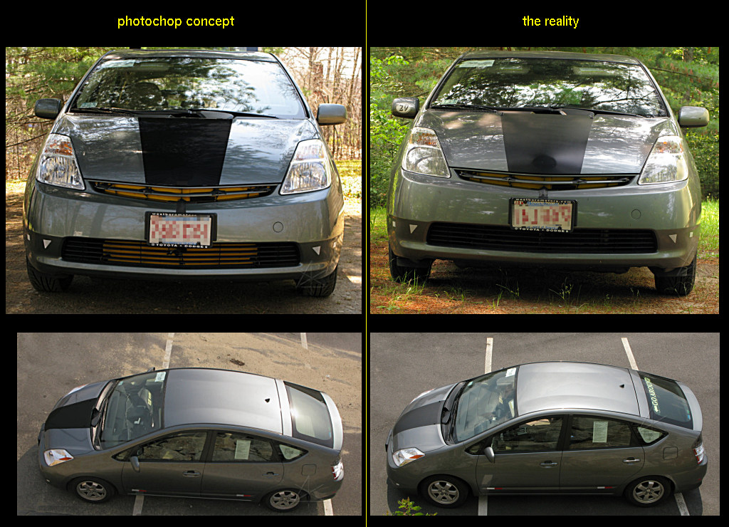

    I've added a second chapter to my de-logoing saga, sort of
    following its development here. I expect that eventually there
    will be a third.
    _H*

    I finally finished the job:
    Details/procedure are here.
    _H*

    That came out great. I'll give you some leftover black pipe insulation to replace the orange if you want to coordinate your colors.

    Great project!
    A lot of hard to reverse work though.
    Couple questions:
    Why not buy car body graphic black vinyl and stick it on (would have been almost exact same look), then peel it off when you changed your mind?
    Why did you want a triangle-like shape instead of straight?
