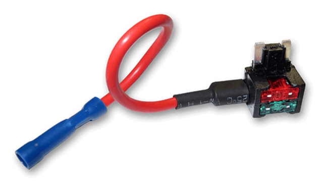

    U can come off the fuse box that's under the dash with one of these
    Look for an existing fuse that's got power when accessory mode is on. Remove that fuse & put it in the fuse tap. The 2nd slot in the fuse tap is for the USB charger. Now connect the 12v+ from the USB charger to the butt connector on the fuse tap.

    That's a brilliant solution!! I'll try and find one of those. Just out of curiosity it looks like two different amp fuses in the picture. Shouldn't they both be the same?

    Doesn't need to be the same. The one closer to the original fuse slot should be the original fuse, the one above can be rated the same, or less than the original fuse. Put an appropriately rated fuse for the equipment you are adding.

    No. They will not be the same. 1 fuse will be from the original location.
    The 2nd will be a 2 or 3 amp fuse
