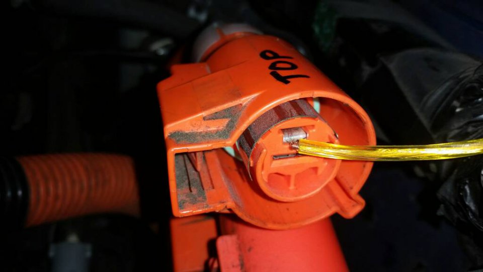

    wardtp. I just did a bunch of testing:
    Standard resistance testing:
    1. I decided to extend the cables of my meter to measure the resistance of each end of the long cable from one end to to the other end. the results were good, there was conductivity with no loss on each cable.
    2. I tested for conductivity again from one end to the other end but this time I connected the cable to the metal jacket/sleeve at the invertor connector and this time I got about 2.5 Mega ohms of standard resistance on the upper cable and infinite resistance on the lower cable.
    Megometer resistance testing:
    1. I measured each cable from the invertor side to the closest body ground on the front of the engine and I got infinite resistance for both.
    2. I then measured the upper invertor connector at the metal jacket inside the conductor as you described and I do get conductivity but only when I use the Megometter. when I use standard resistance it doesn't detect any resistance and it goes to infinitive.
    I think this means that the upper cable is slightly faulty. I am planning to compare it again with the ones at the junkyard to test the resistance of the metal sleeve jacket. I only tested them to the center conector for the cables and they all had infinitive resistance like mine when using the megameter.
    Then I got underneath the car to inspect the cable run that is embeded in a hard plastic outer shell. I did find an area that was a bit rough where it could have possibly rubbed against or be hit by a road hazard. I think this could be a possible source of the faulty cable as I don't see any water intrusion or corrosion at any of the ends.
    lunacy, no electrolites issues here. like Wardtp said, this is unlikely in this area.

    This is the frame wire connector showing the center conector and the outer metal sleeve/jacket that Wardtp and I are referring to. this is using an extension cable so I can reach from the front of the car to the back of the car with my multimeter. 20191221_104150.jpeg 20191221_104103.jpeg

    The high-voltage cables are shielded. The outer shield is continuous from end to end and through the connectors. All of the high voltage parts of the circuit are floating with respect to body ground, but the shields are grounded to the body.
    That has a couple of effects. 1) any shielded cable will tend to reduce the emission of radio interference if there are rapid changes of the current flowing within. I don't know if this is an important reason for Toyota shielding the wires in this case, but it's one popular reason to shield cables. 2) the end-to-end grounded shield means that any damage to a high-voltage cable anywhere along its length can be immediately detected by the car's ground-fault detector.
