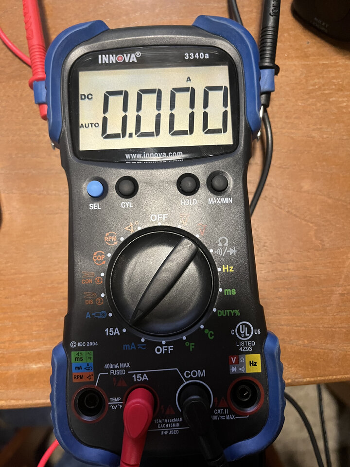

    I’m trying to manually bleed the coolant in my prius as per the instructions in the video linked at about the 1:00-2:00 mark
    I have included a photo of my multimeter held next to the video of his and his settings. I’m lost, can someone circle the proper settings on mine and reupload?

    He uses a 10amp connection but mine is 15amp, that should be fine right?
    He also says something about continuous mode?

    First double-take: why is there a video saying you need a multimeter to bleed coolant?
    Ok, the video shows using a multimeter as a jumper wire across the CHRS pump relay socket, as a way to get that pump to run without using a scan tool.
    If you don't care about seeing an amps reading while the pump runs, you can do the same thing with a humble jumper wire.

    If you stuck a humble jumper wire between the same two relay terminal sockets where this guy puts the meter probes, the pump will run, and will draw the same amount of current it would with your multimeter. The multimeter is a current measuring device, not a current limiting device.
    (The multimeter does, though, have a limit to the current it will withstand, which is why you'd have to be sure the probes are in the higher-range sockets on the meter. Exceeding the limit will blow a replaceable internal fuse in a good multimeter, or do something else in a cheap multimeter.)

    If you look at this new attached image do I look ready for business?

    That relay socket is jumped using the ammeter setting on a multimeter. Ammeter means that it reads current. (Why not Amp Meter? Apparently because it sounded odd to people back in the day.)
    Ammeters can get a little tricky because most multimeters have sockets which must be used for particular ranges, and there is usually fine print concerning usage only found in the manual. The ammeter works by putting current through a device called a shunt, which is just a resistor with very low resistance, then it measures the voltage across the shunt. V/R=I, R is set by which mode/shunt is selected, V it measures, which gives I, the current. The multimeter on the right has a range "A" (no specified value) and 30A (30 amps). The manual for the Innova indicates that it has 3 ranges:
    https://csr.innova.com/Content/Manual/Innova/030412_3340A_93-0067_RevB_English_Final_downloadable.pdf
    (page 6)
    but you can rule out the first two because they are 40 and 400 mA, and the pump will likely exceed that. The 15A socket has a note that it shouldn't be used for more than 15 seconds continuously, and it should rest 15 MINUTES between tests. It also states that the 15A socket is NOT fused and the lower ones are. So using it in those modes would likely blow the fuse inside the multimeter. They can be replaced, but sometimes it is a royal PITA to do so. Aiman's video says to run the pump for not more than 30 seconds - 15 seconds longer than the Innova says is acceptable. In this particular situation I would suggest using that multimeter for 10 seconds in the 15A mode (one lead in the 15A hole, the other in Com(mon) hole, dial turned to 15A) to be sure the current drawn is sane - in this case less than 15A. Then just use a piece of wire to jump the relay for 30s at a time. The only danger would be if the pump shorted out completely during the bleed, which is unlikely. Well, the other danger would be sticking the probes/wire in the wrong socket holes - don't do that, it will almost certainly blow a fuse in the car.
    For whatever its worth, I did this once using a free Harbor Freight multimeter with a 10A range and only rested it a minute or so between 30s bursts, and it survived. (HF has since raised the price on similar multimeters to $4 and downgraded them to 5A DC.)

    That's because that pump doesn't kick on in maintenance mode or heater on or what have you. It only comes on for a few seconds, once, before cold-starting the engine if there's hot coolant in the thermos, and again, once, for a few seconds, when you shut the car off, to save hot coolant in the thermos.
    Yes. (Again, the meter isn't doing anything for you there that a simple wire wouldn't, but if you insist on using a meter, the way you've set that up will work.)
    They probably calculated the time limit for a current that is near the 15A maximum. You can probably get away with 3 or 4 amps for longer than that (though the meter vendor might show little sympathy if you don't).
