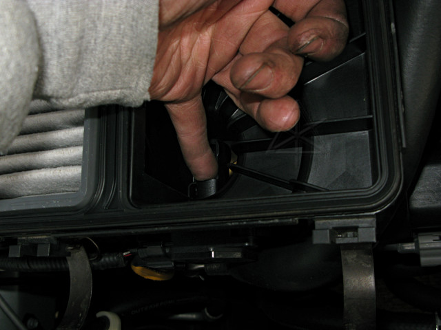

    Hobbit,
    I think a MAF high/low signal is a 2 trip code. It probably did store a pending code, but won't turn the MIL on until it happens again. It is monitored by the CCM for electrical circuit integrity (open or shorted) which should result in an immediate light by unplugging the sensor with the ICE running. Did you scan it after the "digit test"?
