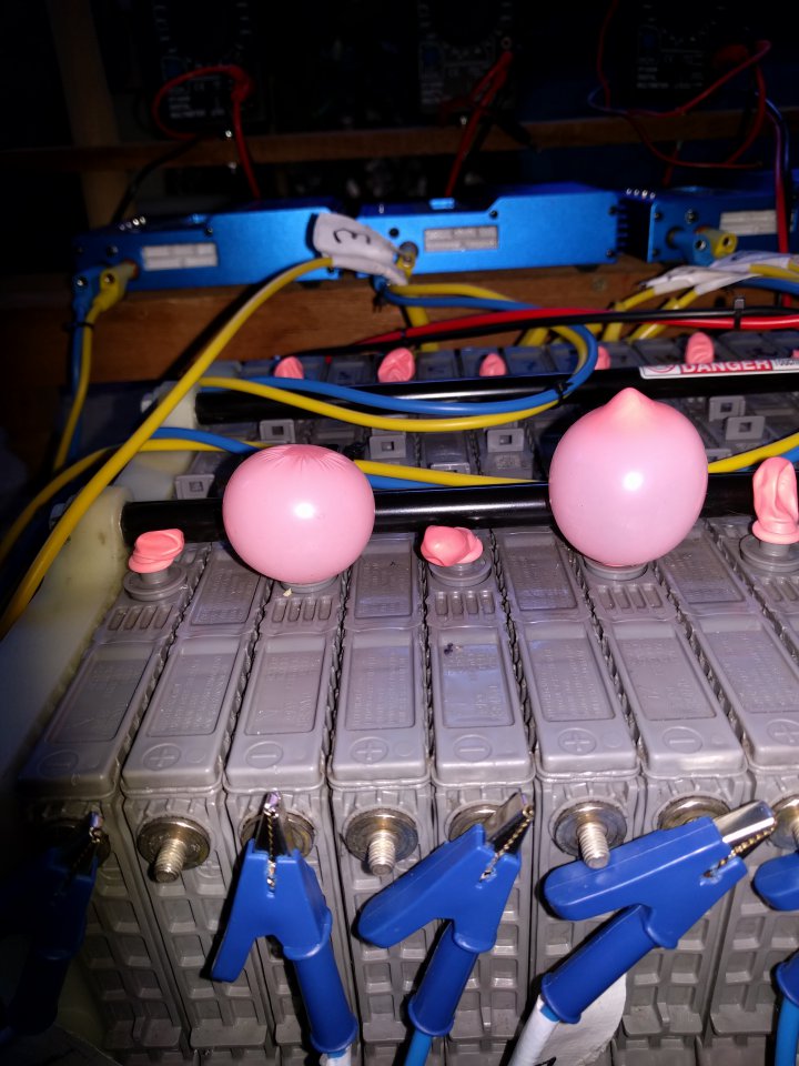

    998BA312-967F-42D5-B4C1-B89A88CD5850.jpeg So I’m going to try recharging each module And load testing with this rudimentary rig. And away we go....
    Raytheeagle and Mendel Leisk like this.

  20. SFO
    SFO Senior Member
    Feb 7, 2017
    5,302
    4,252
    Northern California
    Which reminds me of this picture posted by @PriusCamper
