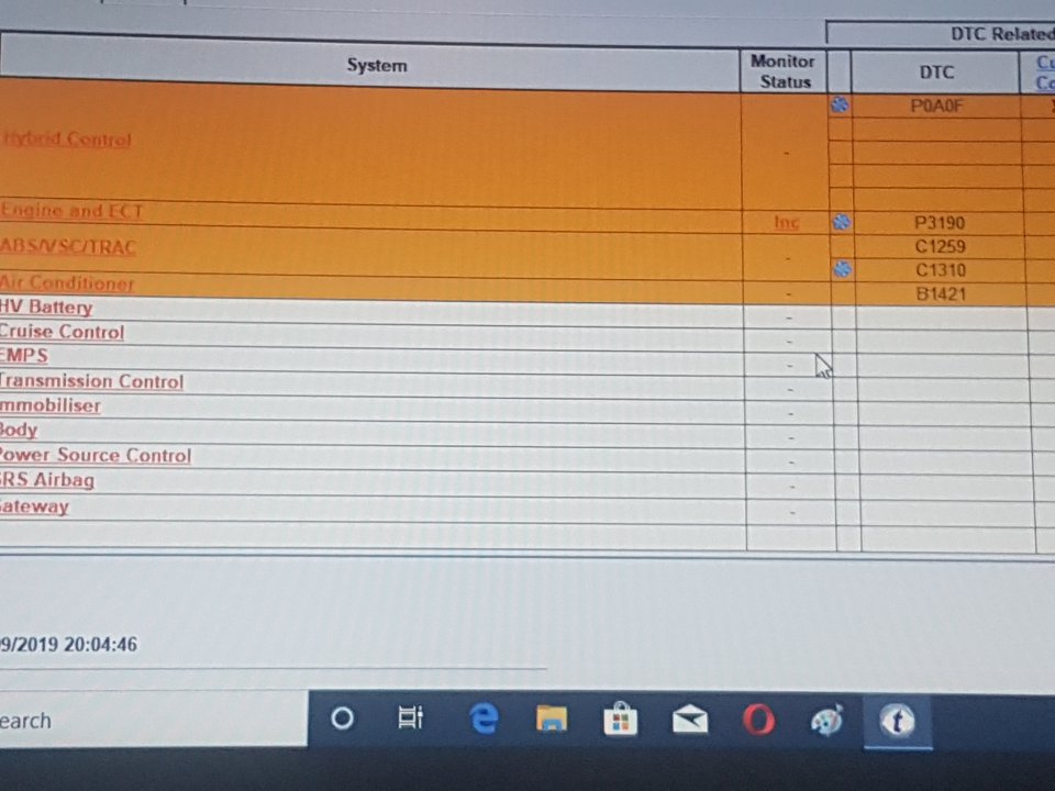

  3. SFO
    SFO Senior Member
    Feb 7, 2017
    5,302
    4,252
    Northern California
    Was there a small bluish flower/cloud icon that you could click on, just to the left of the P0A0F. Example in the image below :

  4. Ianmeister
    Ianmeister Active Member
    May 21, 2019
    316
    320
    Meridian Idaho
    ----USA----
    Hmm there may have been. I’ll try tomorrow

  12. SFO
    SFO Senior Member
    Feb 7, 2017
    5,302
    4,252
    Northern California
    Was anyone able to click on the cloud/flower icon and retrieve the 'subcodes' / INFs ??
