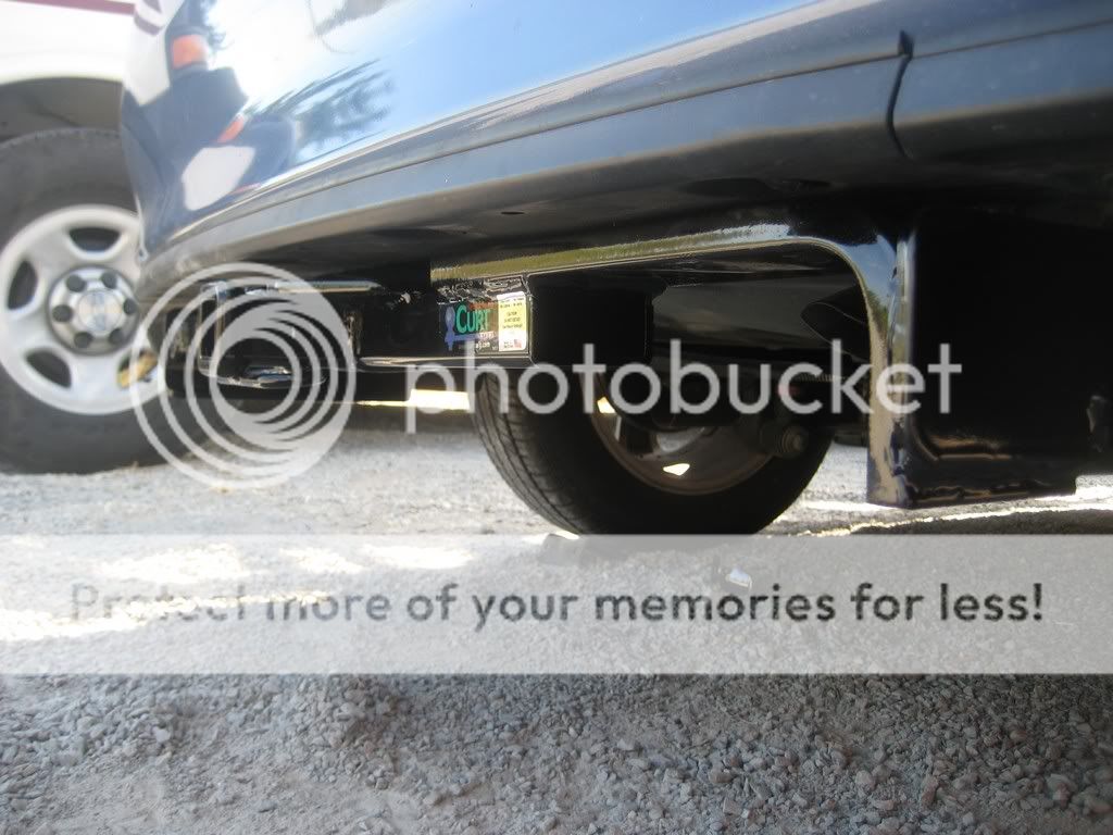

    I'm hitched. Easy install thanks to Prius Hitch
    No bolts came with my order (Amazon). The existing tow points had screws already and they worked great. Much better than the bolts that are allegedly in the hitch package. I need to get a 1 7/8" ball and wire up this puppy and I'm ready to pull!

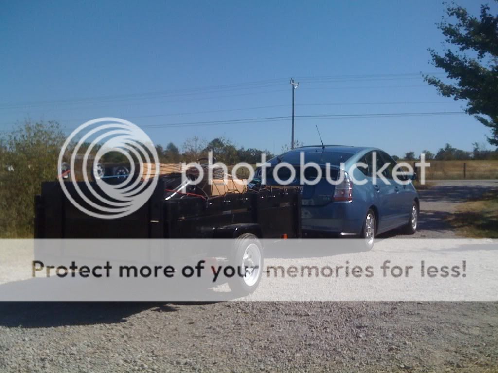

    Re: Hey let’s get hitched!
    Here's a photo before our first tow. We hauled a few hundred pounds of kids clothes to a yard sale this past weekend at my sister-in-law's house about 100 miles away. It towed like a camp. I got better gas mileage loaded than empty, what's up with that? Anyone that's on the fence go for it!
