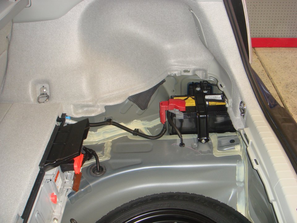

    im finally at stereo shop getting system installed.
    im putting the sub in trunk.
    will this damage the battery pack at any possibility?

    Not if done correctly. I power my JL HD900/5 Amp off the 12V, with turn on through ignition/Start. Don't forget to fuse it.

    So long as you are always in Ready when you use it, no. The Prius has a comparatively small 12 volt battery, but in Ready mode it gets supplied with up to 1000 watts through the much larger HV Battery, which is itself recharged by the engine as needed.
