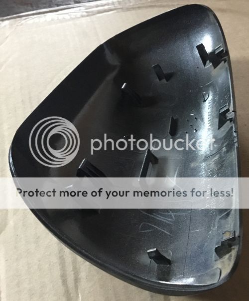

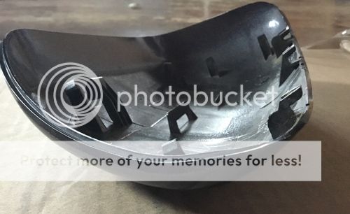

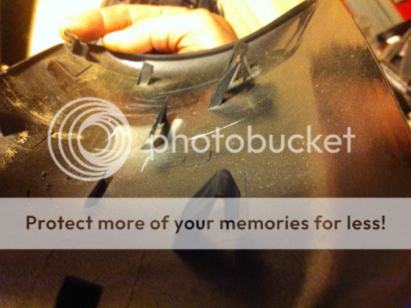

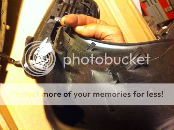

    Don't have any pictures myself of the back side but this is the image that helped me of a G3

  7. artrockets
    artrockets Member
    Aug 14, 2007
    39
    39

    Without arguing whether it's possible to do without popping the glass out, I'll just say: I pop the glass out. It's easy, it's made to pop out, and the claws you push on to free the color cover are right there to push on after you do.

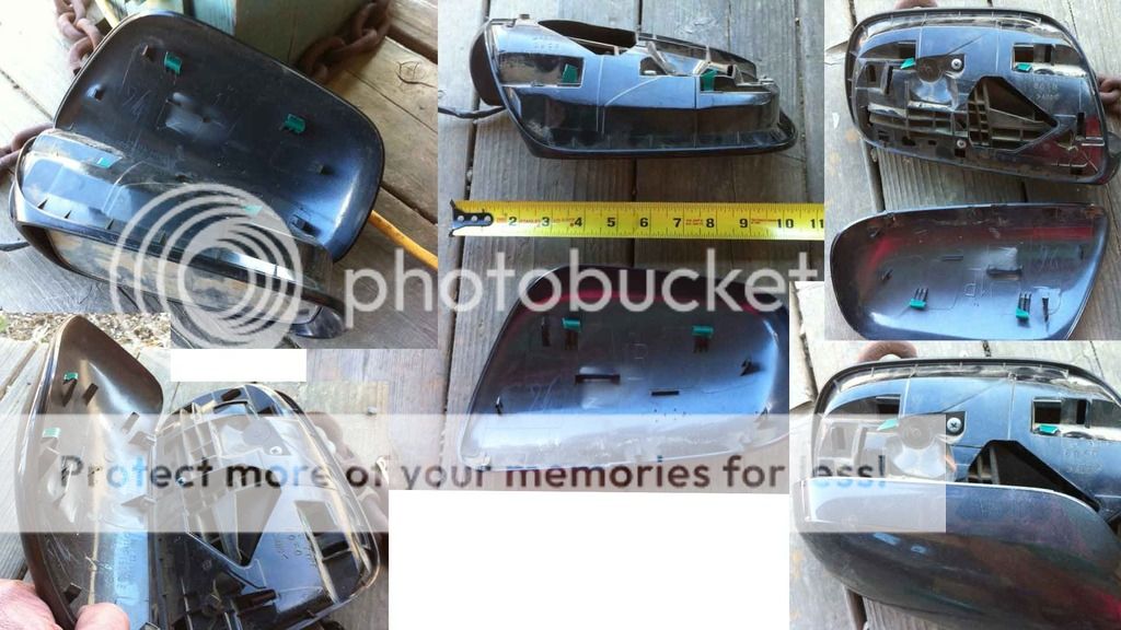

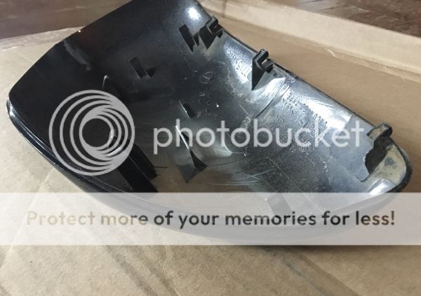

    My pics are all messed up.. you can get in above the mirror into the cowling(between mirror and cowling) with a thin flat blade and release the 2 clips that hold in the middle..
    2 clips in the middle and 3 hooks along the bottom..
    maybe adjust your mirror either full down or up and se if you can see back there with a flashlight.. Ill try and get my pics working..

    I put some bits of green tape on the 2 bits you have to hit to release the mirror...
