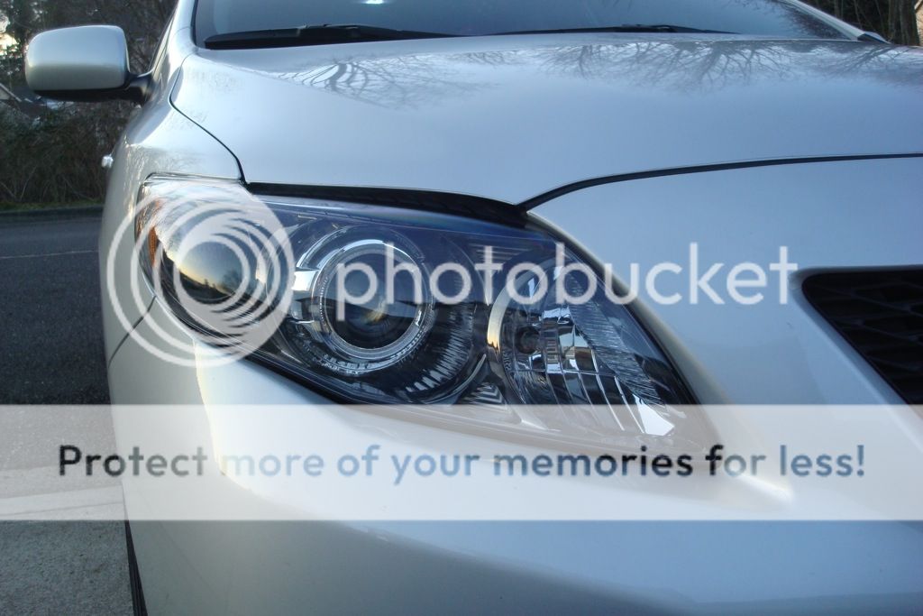

    I just bought a complete kit from TRS with Mini Kit for my 09 Corolla. It turned out nice. :D

    Nice!you did the retro yourself? Which mini? Please say the H1. LOL

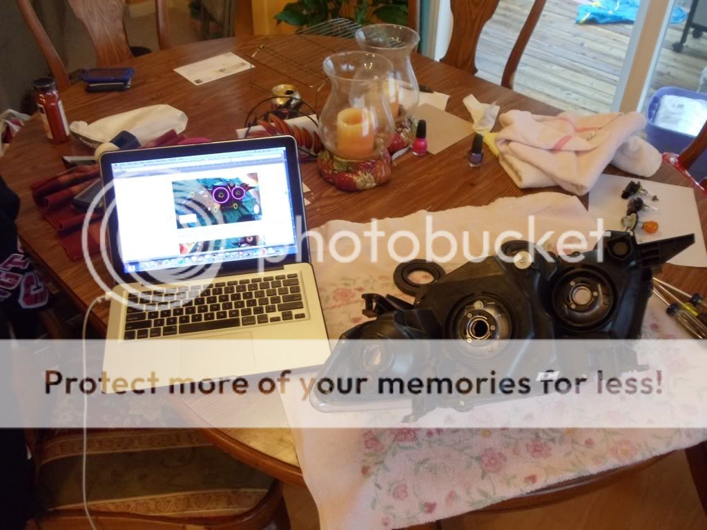

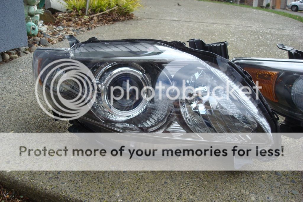

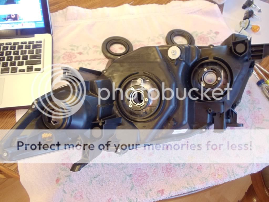

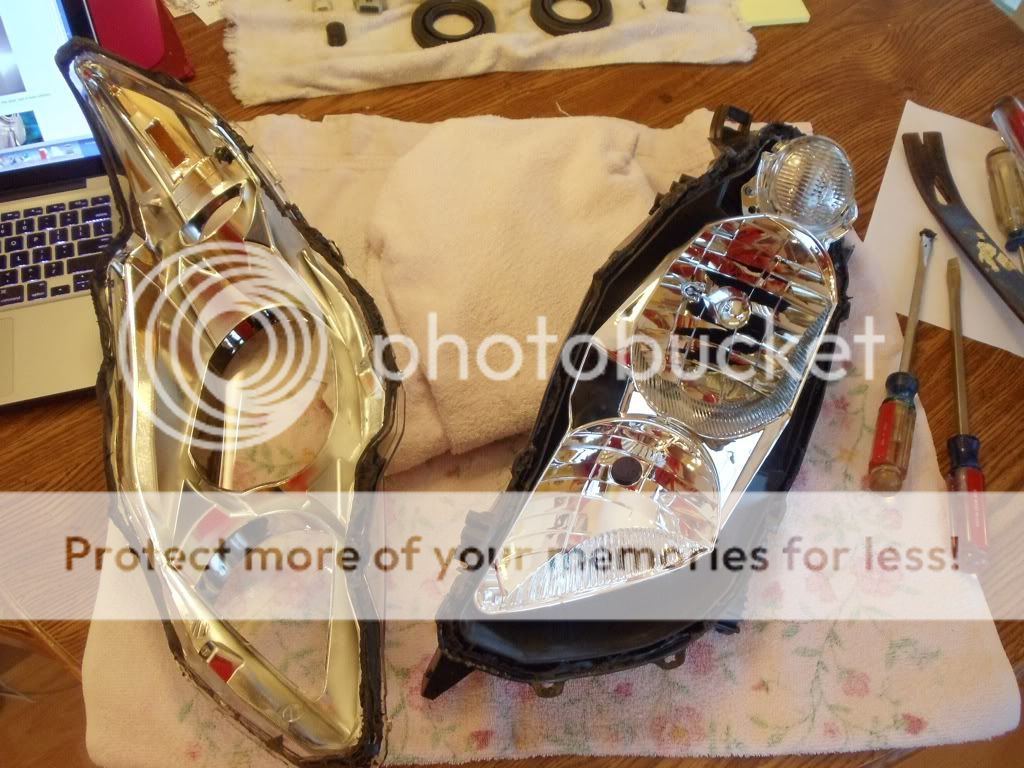

  14. SuperchargedMR2
    SuperchargedMR2 Diehard Rams Fan
    Feb 13, 2011
    673
    179
    Vancouver, WA

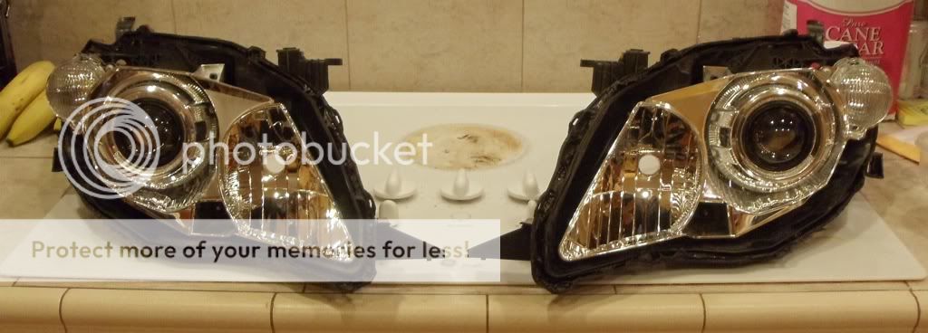

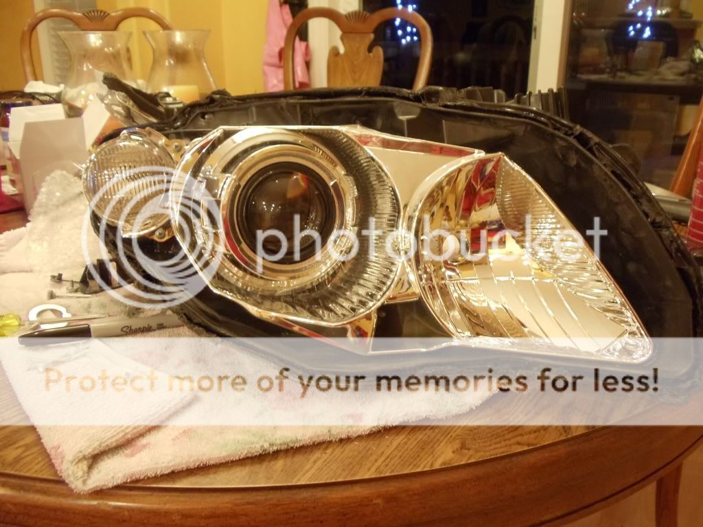

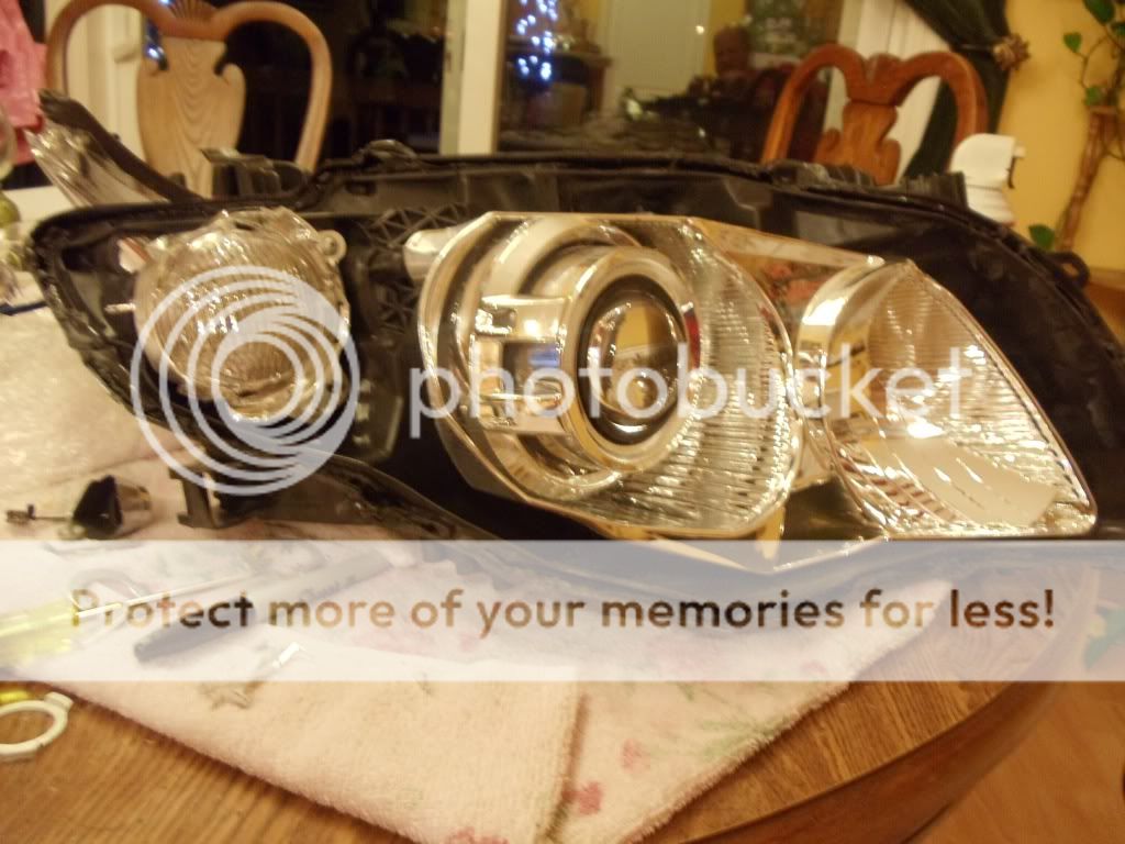

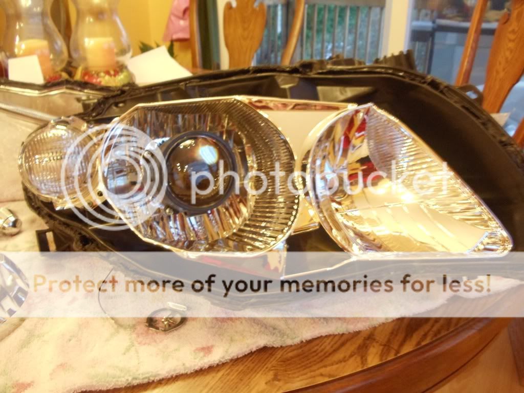

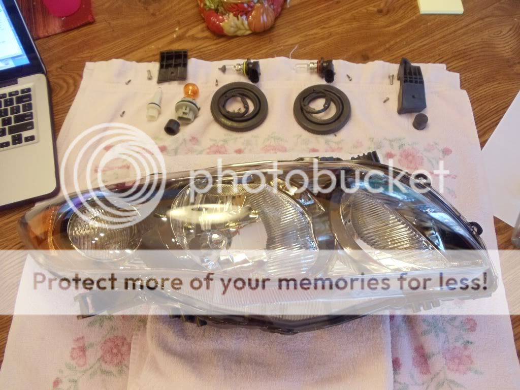

    Yes I did the retrofit myself. :D I bought the bi-xenon Morimoto H1 4.1 projector kit. I love it. I also bought a second kit for my 95 Previa but I haven't done that retrofit yet.
    Here are some pics of the process.
    2 people like this.
