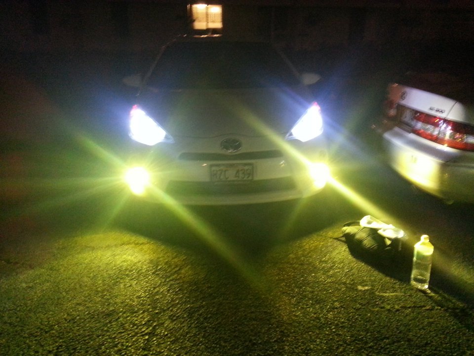

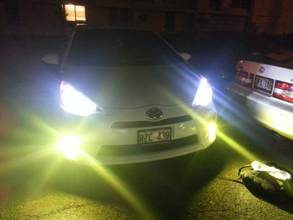

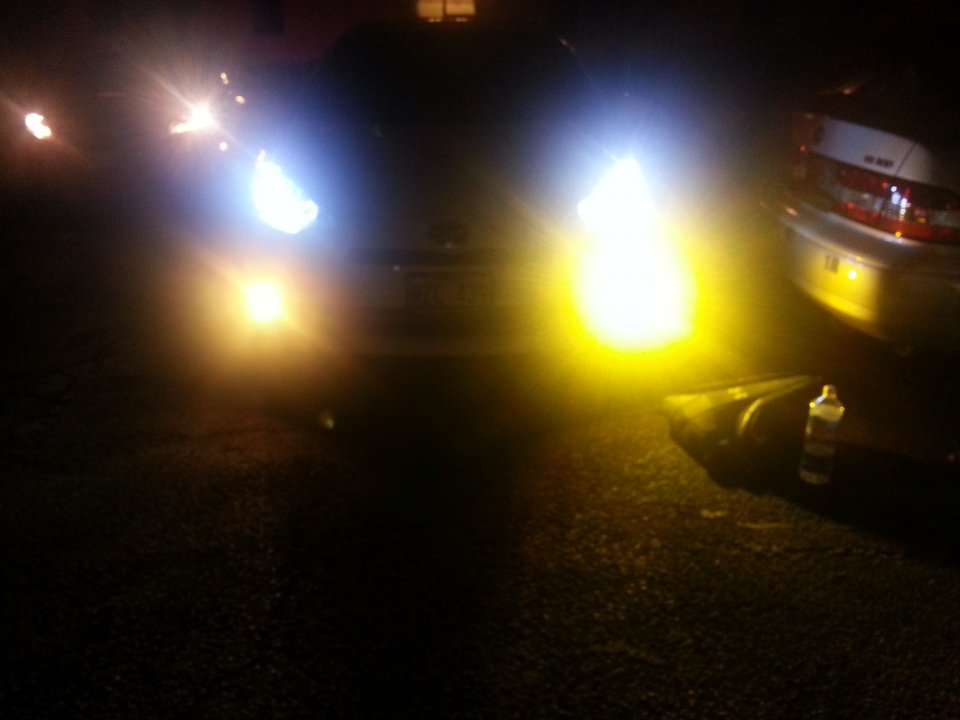

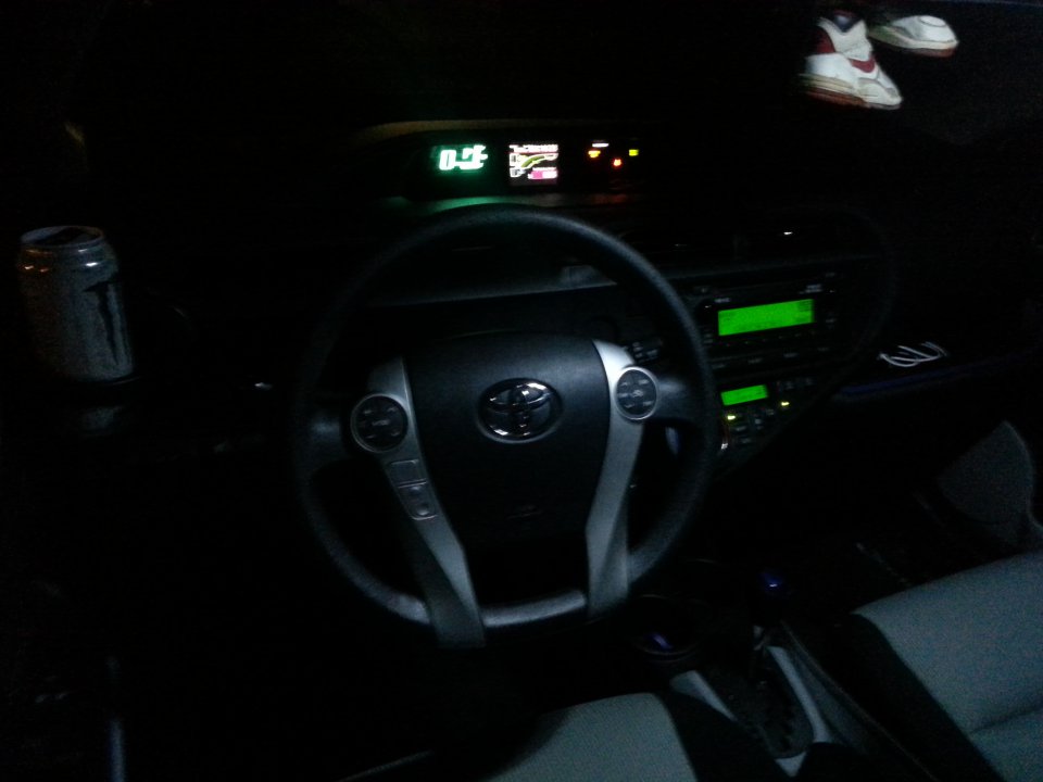

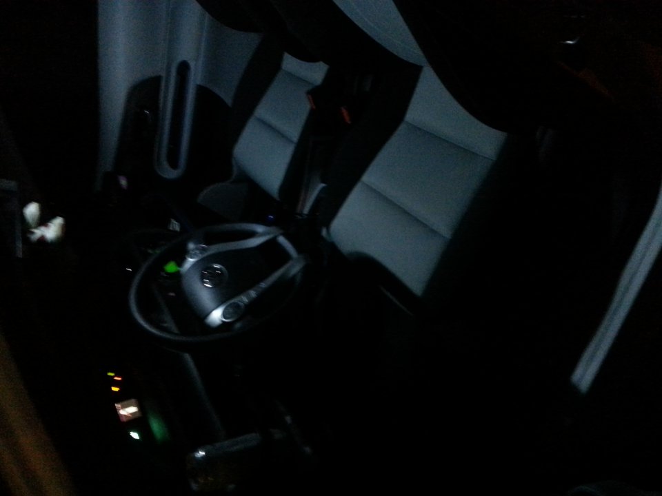

    Forgot to type some stuff in. interior pics suck. but wanted to show the led maps and the airvent cupholders. also the fog lights before and between the HIDs. really lights up the road nicely. now i just need to change the signal flasher, which i can't seem to find to stop hyperflashing. and, NO i do not want to add load resistors, just because. Also if anyone knows how i could possibly hook up the fogs to the drl pin so that i can run the fogs on all lighting modes. or independently would be good too.

    looks um... very bright lol

    That's a lot of glare from the HID foglights. :(
    I'm glad we won't be crossing paths ever. The reflector based foglights aren't good candidates for HID because they lack a cutoff shield to keep glare from blinding oncoming drivers and people in front of you.

    I have already done road tests for oncoming and while behind others in traffic from a different vehicle. There is no "dazzle" effect. The fogs are low enough to not be a bother. and as I am sure you know that such lights would be reserved for low visibility road applications, so it is comforting to know that I will not be out of luck when my low beams are not enough. Especially since its my primary family vehicle.

    And no matter how much you argue that your foglights don't throw glare up above your lowbeam cutoffs, the camera doesn't lie.
    In all of your pics above showing the foglights, they are throwing stray light (glare) into the camera lens producing flare in the pictures. The lowbeams are not, because the lens is above the lowbeam's cutoffs.

    Can you see which one of my pics look like your reflector based foglihts with HIDs? That's right, the one with a lot of light hitting the camera lens. But in your case, you can tell there is a lot of light output above the lowbeam cutoffs, or your lowbeam lights would be flaring into the lens as well. But they are not.
