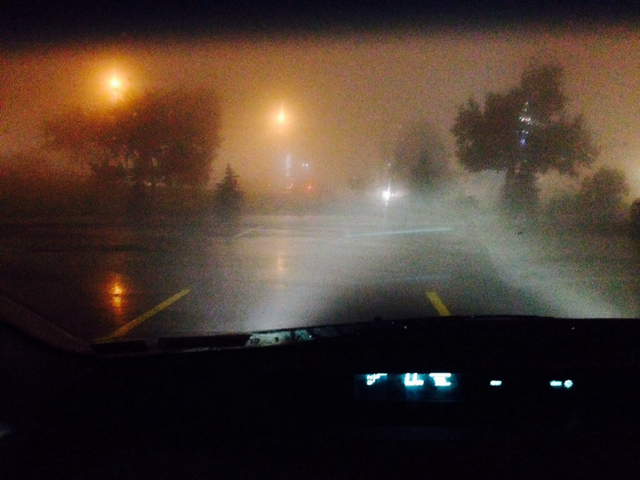

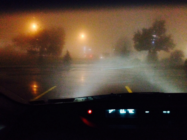

  8. NedBinCNY
    NedBinCNY New Member
    Jun 18, 2014
    Syracuse, NY
    Oh yes, low beams only:
    Ned
    Low plus fog lights
    I'm parked btw more later
    Ned

  9. xliderider
    xliderider Senior Member
    Apr 19, 2012
    8,140
    3,277
    Honolulu, HI
    Try and find a level area with a flat wall about 20 to 30 feet away to see your cutoffs. They appear to be too high in your posted pictures.
