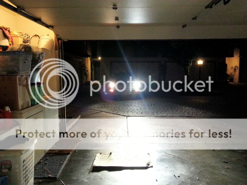

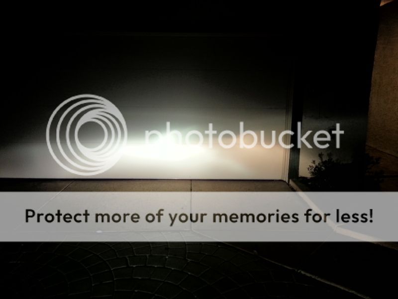

    Left: Osram Night Breakers Plus ( The best incandescent on the market ) Right: eBay Special HID kit

    OP, you've got a lot of glare off of that HID bulb. I'd hate to be driving in front of you, or approaching you from the opposite direction. :(
    The reason you "can see way down the road" is because it's like you are driving around with your highbeams on.
    DGH likes this.

    LOL, yes, I lowered my beams by 1 inch from spec. :D

    My 911, was not meant for HID, I forced it but I love the light that is thrown and it is much safer IMHO.
