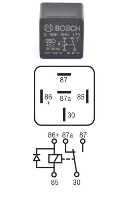

    Is your setup good enough without adding any 12 headlight volt relay?
    I mean If I cut the 12 volts direct wiring (before the ballast) that more likely came from the headlight switch can it take the amperage load of the new LED light bulbs.
    I can easily buy a relay and rewire it if there is a question about it because I use to work for my uncles electric shop. It's gonna take me an additional 3 hours to get the relay, make the wiring harness and plugs since i'm not really equipped for this job including I'm not sure if I can get 2 of these parts locally.

    The wattage on the LEDs is low enough that you don't need the relays.

    No relays just pickup 12V at the cover two wire plug in conn .close it up . You won't be back in there for your tenure with the car. Ballast bypass is perm. As you're on fixed 12 V unless battery fails . You may need to setup the housings for led . To get cutoff on wall etc
