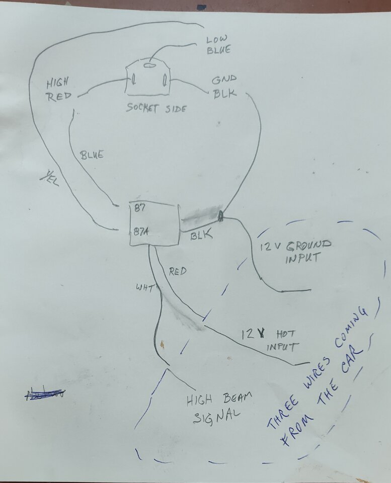

    But actually, since I originally posted, I have totally converted the headlamp system to halogen instead of the original HID. I went through a couple of different sets of LED lamps, but never did find any that were bright enough. I think a big part of the problem was that the clear plastic of 18 year old headlight assemblies was all frosted and dull and blocked a lot of the light output.
    So it is now converted back to a 2007 halogen system, (NOT HID), and I LOVE it. The lights are much, much, brighter. After having done the previous LED conversions, it wasn't too difficult, but it wasn't easy, either. There are threads on the forum saying conflicting information, but I went along with what made the most sense.
    I bought the parts from Amaz## and the parts were $121 for the pair of new headlamp lens assemblies (the great big things),
    $12 for the pair of halogen light sockets, $20 for a pair of Hella halogen bulbs, and $11 for a pair of relays and sockets. Total was $164 for the entire project.
    One issue is that the headlamp lens assemblies do not come with the big 4" diameter covers that go under the hood. I ended up making some out of plastic because they were ridiculously expensive to buy.
    I did this 3 months ago and still had the cheesy schematic laying around. I have part numbers, etc, and could improve the schematic, but tell me what you are trying to do.
