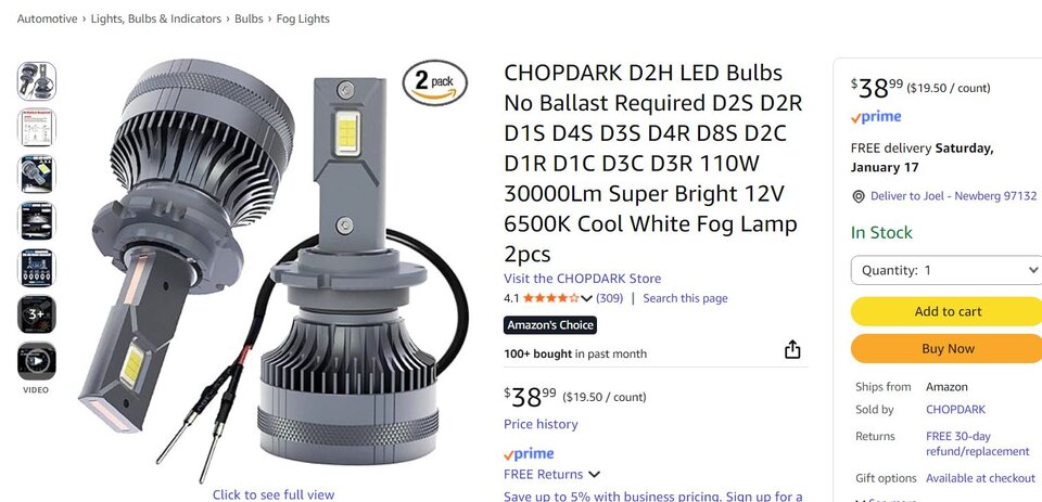

    Can you please provide a good link for this conversion? I also have a 2007 that originally uses a HiD. The car is called 2007 Prius (Not Touring) Pacific Northwest package 6 basically fully loaded with leather seats, JBL system, Navigation, Alarm and HiD. My car has been getting this issue of headlights on and off for a year now and I cant use it at night. I couldn't replace the original because it requires a ballast and the new bulb that will cost over $500 bucks from the dealer. Is this LED a direct replacement bulb? Anything will help and thanks,

    Just checked this. The lights are chopdark on amazon. They hook directly to the two 12v wires and bipass ballast.

    Yes it fits in the same slot and mounts fine. Inside the assembly wire the two wires connected to/thur the dust cap and disconnect the ballast completely. I removed the ballast completely and put the seal and metal ballast cover on to seal the hole.

    I'll just go with the LED and get rid of my HiD is it will work. So is this the one?

    Yes. I removed the headlight assembly and wired these inside the assembly only 2 wires. Was easier than it seems. Drop the front bumper don't need to fully remove but just enough to get to 3 10mm bolts to remove headlight, then remove the dustcap and wire the 2 wires connected to the bulb directly. I used some of those plastic snap on connectors. Has worked find so far.

    Okay so just to understand on this follow-up on this conversion from your original HiD. The only one you replaced is this LED below and the old HiD housing remains disconnecting the ballast and wiring it the existing 12 volts switched in the steering control .. Is that correct?

    It looks like they also sell a $56 D2H version with a blade type plug, but other than that, I cannot tell them apart. The $38 D2H in your screenshot has needle styled connectors. I've never done this before, so just inferring that the needle style plugs are more compatible with the wiring that is on the hard plastic dust cover? Can you share what kind of snap on connectors you used to bridge them together?

    Read post #3 in this thread. It explains about the connectorization of the 12 volt supply going into the headlight assembly. I looks like the 12 volts terminals coming in from the car are 3/16 male push-on blades. Therefore the wires on the new LED lamps would need to be 3/16 female push-on blades. Changing the type of terminal/pin (round to blade, etc) is pretty easy if you can cut and strip the wire and crimp on a new terminal.

    Okay.. so I already bought the one on the picture but I have a 10 amp Dean connector for RC planes both male and female which I can convert the car easily and hope that would work?

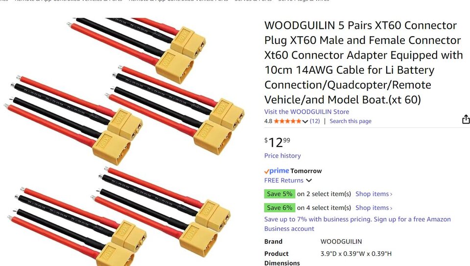

    The only reason why I'm using the dean style connector. I already have those from my airplane pack supplies. Use this instead which is the XT60 connectors 14 gauge wires. These are better because they are sealed when connected. But you have to solder all 8 wires to your car and quick disconnect. This set is more than enough for what you need to make everything easy for quick connect and disconnect.
    XT60 Link:
    or get it at amazon:
    WOODGUILIN 5 Pairs XT60 Connector Plug XT60 Male and Female Connector Xt60 Connector Adapter Equipped with 10cm 14AWG Cable for Li Battery Connection/Quadcopter/Remote Vehicle/and Model Boat.(xt 60)

    Perfect! Just what I was looking for! Soldering and shrink sleeve is not an issue at all.

    Thank you for posting the LED. I been spinning my head of this for awhile. I don't wanna spend 600 bucks for HiD that will possibly blow up again next 5 years.

    They mount exactly like the original. There are two wires that go thru the circluar screw off dustcap. I cut the wires on the inside of the headlight and hard wired them Not the wires in the engine bay. I used Ideal push down wire connectors from lowes but you can connect the wires however. If I can remember I hooked ground to black wire but dont think it matters. I can maybe get a pic of the dust cover. You want the lights with the push pins not the connector. Can prob just push the pins in without cutting wires but i cut the wires and hard wired it.

    Ive seen elaborate cutting and rewiring the car harness wiring on youtube but found none of that is neccessary. This worked for me and I didnt need to mess with car wiring outside of the light assembly.

    Ooops so the LED is polarized if thats correct? I'll just figure out the connectors when I work on it. I still have to finish recharging the hybrid batteries. I have to replace 1 or 2 cell modules.
