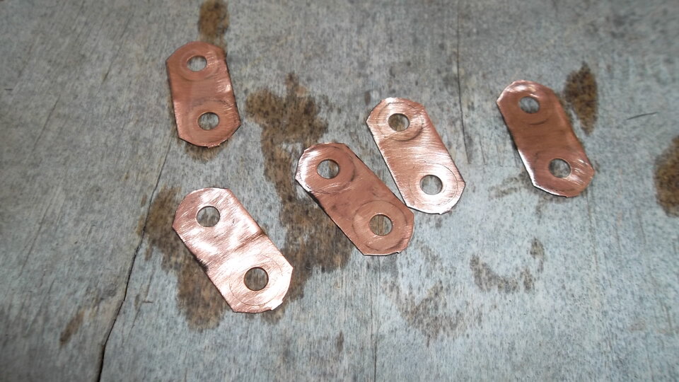

    in your case and since you have a new battery which is great! Just change all the buss bars and the wirings so you can close your eyes in the next additional 180,000 miles.

    If you run even the strongest battery to a wire that has a low continuity, it will drop the amperage and increase the voltage that will utterly eat your battery cell life without knowing and will die abnormally. The buss bars and the wirings can be those in your case. You can always replace those without pulling the battery out. I'd ask some of these guys in Prius Chat since some of them has experience enough with dealing with these and pointing you out to a quality buss bars and harness.

    A factory new battery comes with all that on the battery side of the Battery ECU and the relays, However, you need to reuse all the stuff from your old battery that connect to those three main connections.

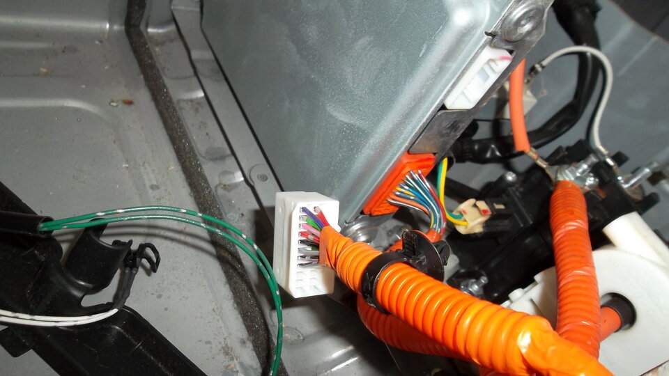

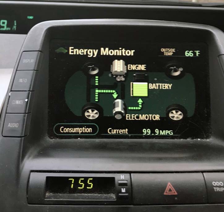

    I gave the car a stretch drive of 200 miles on the freeway. Can this be real from my old 41 mpg right before I blew up the hybrid pack?
    It runs great.
    Now I have to get to the LED conversion next week.

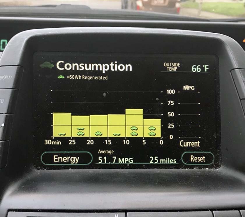

    I have all the pictures and correct process of doing it in case you guys need it. I learned along the way that there are very, very small numbers of "used hybrid battery module" source/seller that really knows and honest. Initially I saw one dead module and 1 that is failing. The more that I got into it, the more I understood how the battery pack really works and how to rebuilt it the right way. I ended up replacing 13 modules due to realizing that I missed a big part of the Prius's over 100k maintenance.
    Winding back a bit when it was around 100k or up,I should have at least reconditioned the battery pack by doing the 5000/6500mah cycle, read the cell life, arranged the modules to its proper life positioning then rebalanced the whole thing before installing it. It would have prolonged its life more and gave me more mpg and obviously more power. As I read the original 2007 manual
    "Fuel Economy: Approx. 60 City / 51 Hwy / 55 Combined MPG"
    For whatever if it's true or just a sales pitch, the obvious number in the regular (non stressful stop and go) city driving is obviously better mpg than the hwy driving above 55 miles per hour. This was not the case when I got the 07 Prius at 98k miles. The city was already 43 mpg and the hwy was 45 mpg. Then as the years go and the odometer mileage gotten bigger, The mpg gradually went down all the way to 38.5 city and 41 hwy.
    After the hybrid battery rebuilt at 175k miles today, the 2007 Prius is averaging 51 mpg on city driving and 45.8 mpg on hwy. It felt like it went to the correct pattern of the way how the car was really designed in its present engine mileage and condition.

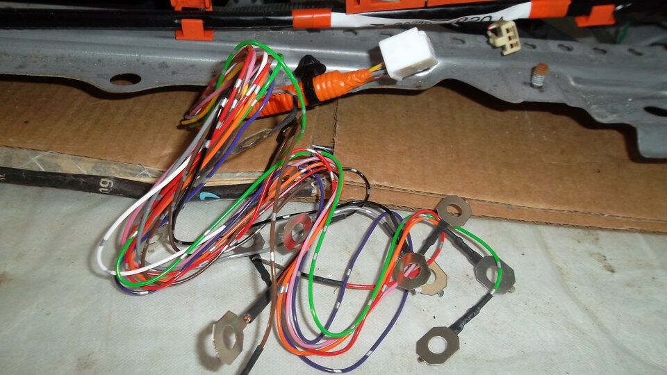

    Nice harness work in your test set-up with the red and black conductors! Looks like you take some pride in that sort of work, like you were building cabinets for military equipment that were going to get a documented inspection and test, LOL.
    I don't re-set the mpg history calculator on the Prius too often. Usually wait for it to settle out after a several months. But no matter what the mpg is indicated on the display in the car, I always have a little internal chuckle when I am next to someone filling up their thirsty Tahoe at the gas pumps.
