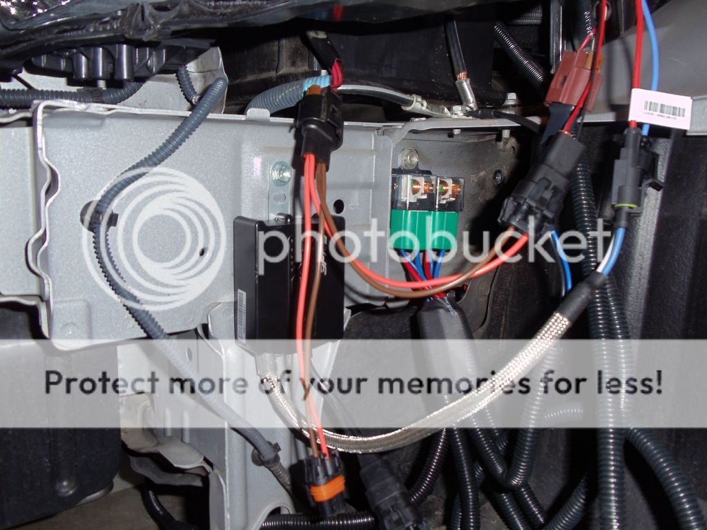

    Yes, to protect the wiring & get maximum brightness from the bulbs. I just did a HID retrofit on my 09 Corolla & wired in the harness with relays. :D
    You can see the relays in this pic.

    Necessary? I would say no since the stock wiring provides enough power for the bulbs. I think the Volts would look exactly the same whether the power came from the existing wiring or from a relay since they are a quality set. Not sure what a Corolla draws power wise, so can't really compare what a Volt set would do on there. That being said, I think for piece of mind the relays would be a good idea. I was thinking about it on my set, but I think I am going to weight until they finally die (if that ever happens) and upgrade to the Xtreme Digital Kit since they have a 5000K bulb option.
