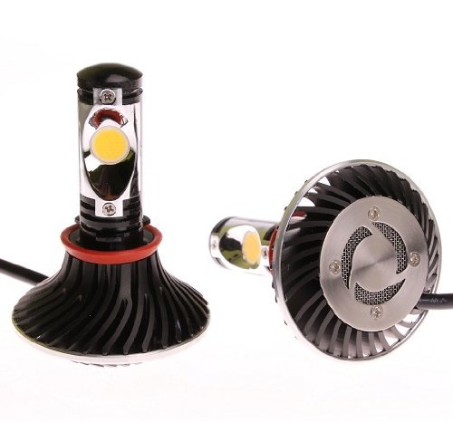

    They are already getting LEDs into a tube like structure like the below pic. I doubt that will be an issue in the near future.

    The lights you have shown project all their light to the side, no light goes out front, where it is needed. All that tube like structure is getting in the way of even light distribution. Talk about ground and everywhere else shadows. :rolleyes:

    Actually, I think the light reflects off a back reflector before going forward.

    How can the light go forward, there is a black plastic cap on the tip of "the tube like structure"?
