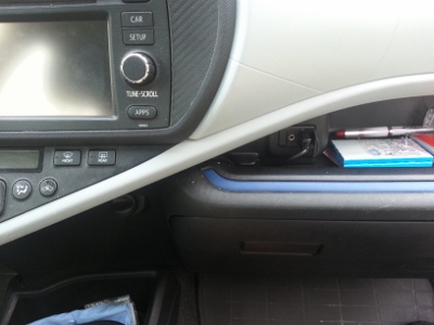

    I am submitting my mad ninja skills for applause, lol.

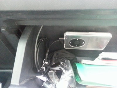

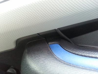

    It isn't so clear but, the in the second picture I had shaved that diagonal gray piece of plastic, for the cable to run under.
    Then, I just dropped the cable straight down into the glove box and velcro'ed the protector case of the iPod to the box.
    It only took 5-10 min.
    The box opens and closes fine. Plus it cleans up the interior a little.

  17. krneidigh
    krneidigh Junior Member
    Mar 18, 2012
    70
    17
    Pensacola
    I used a smaller flathead and a file.
    I placed the flathead under the lower right corner of the radio trim. It pops out a little a then rips free, but there is a connection for your hazard lights.
    Just grab the ac vent by hand and it pulls right out.
    The upper gray part just lifts off, a couple pop holders.
    The lower gray part is a little stubborn. You will be able to see where clips pass through. On the right most clip and the clip at the curve, about where you plan on filing, can be compressed to fit back through the holes. Apply a little pressure to the colored clip to depress it and it will slide right out. Then I just yanked the rest of plastic out; it comes out as one piece, which extends under the MASSIVE temperature knob.
    Then pick a point to file, honestly I don't think it has to be filed all that much. I was just being picky, the cable will fit fine, but I'd know it was slightly warped.
    As you look down into the dash, above the glove box, I draped the cable to the right of the metal support bar and into the glove box.
    Then everything snaps back into place. My wife was staring at me weird when I was explaining it to her, but I had her come out and just take panels off/on. She was amazed by how easy it was to take apart.
