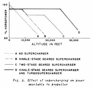

    In outer space (talk about high altitude!!), they don't use internal combustion engines. I wonder why. LOL! Nope. They use ....
    BATTERIES.
    As @Skibob said, engines lose power the higher you go. Hence the super chargers on WWII bomber engines. At sea level, a new Gen 2 ICE is rated at 76 HP. The online calculator I used said that at 8,000 feet (rough elevation of Angel Fire, it would lose 18.24 HP giving you only 57.76 HP on a perfect engine. That's really going to work the battery. The older the engine, the more it'll work the battery and the older the battery, the less work it can do. At 10,000' the ICE loses 22.8 HP, so the passes make it even tougher on a hybrid. The rule of thumb I used to hear was a loss of 30% at 10,000 feet.
    So it can't be that the altitude hurts the battery or else batteries would not work in a vacuum. Altitude definitely hurts combustion, though.

    My individual understanding* is:
    Batteries do not care about altitude
    Engines do. WWII fighter planes all had some form of supercharging to increase HP at high altitude)
