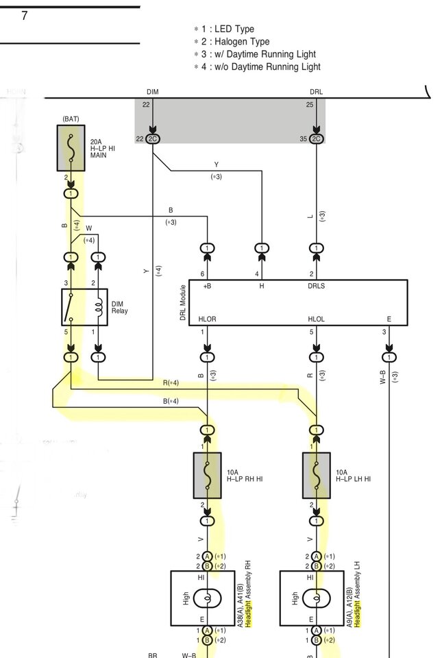

    They've since gone out again. I replaced the bulbs again with new ones but no luck. I also tested the following with a multimeter:
    * 0v in the driver side bulb harness (forgot to test the passenger side)
    * 0v in both of the 10a H-LP RH HI and H-LP LH HI fuses. Tested both sides of the fuse and neither showed anything
    * 13v in the 20a H-LP HI MAIN fuse
    I replaced the 10a fuses just in case something weird was going on but that didn't make any difference, and still show 0v on both sides. The blue indicator light on the dash is still on.
    I'm guessing this means there's a short somewhere between the battery and the fuse box. Has anyone had any experience with troubleshooting this further?

    A short normally would cause the fuse to "blow" (open). You must have a loose connection, broken wire, or bad switch or relay.

    Verify the wire harness connector is not burned or melted. If so replace with ceramic connectors.
    Be sure to check the ground wires as well as the power feed. Each headlight has its own ground.
    As you probably know from reviewing the drawings and not guessing, the DIM relay is essential.

    Appreciate the help. I was able to narrow this down to the relay, and once I replaced that everything seems to be working fine again.
    I tried to check that last time but didn't have a relay puller. I'm guessing jostling it around with pliers was what got it temporarily working, and the bulb was just incidental.
