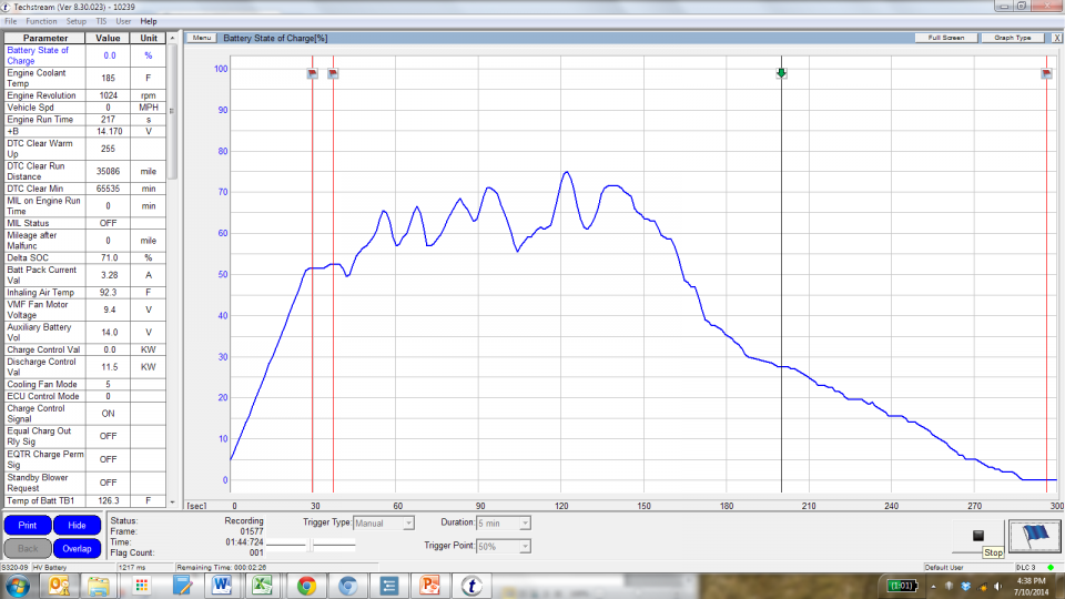

    • See the attached "screenshot 1". I recorded a drive around my neighborhood just to see what happens with the different HV battery measures. Notice how the SOC drops when at a stop (in D), going from 75% to 40% without pressing the accelerator (starts around 280s mark on the x-axis timeline). Is this normal? If not, what might be the causes?

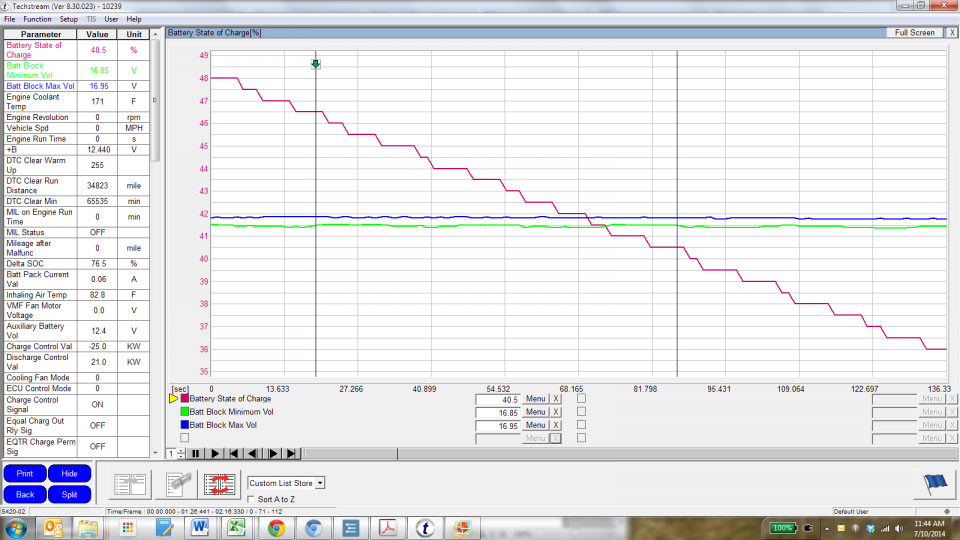

    • Similarly, "screenshot 2" shows a 10% drop SOC within 2 minutes while powered on but with the ignition off (sorry, not sure what is the official name of this power state, with start button pressed twice without foot on brake). Is this normal? If not, what might be the causes?

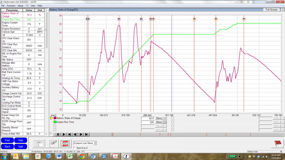

    • Did another brief in-city drive, and got some more weird symptoms. Let the car idle briefly upon startup which charged the HV (see screenshot). Then drove around briefly, after a couple minutes of which the SOC began to plummet all the way to 0%. I didn't think it was possible for the HV to discharge to that point??!!
    • I repeated this sequence two more times, but another drive this evening failed to get the initial charge. SOC sits at 0% (!!!).

    Not normal, as you already know. It looks to me like there just isn't all that much battery capacity. When I sit in Park, with car in Ready mode, engine off, and no accessories or anything turned on save for the laptop running Prii-dash, the inverter and all the various ECUs in the car will create a draw of ~1.5A from the HV battery. At that load the SOC will drop slowly over 10 minutes, but not like what your graph shows.
    I see the battery temperature values look high for just having taken a short drive. 126F is rather too high for a healthy pack. You are not using the AC so the intake is at 92F, but it should not have diverged that far from ambient in 5 minutes. If the battery gets too warm, the HV ECU will limit limit the charging current. If you hear the battery fan running, this would be confirmation of overheating of the pack. (I run my batteries up to full charge all the time, and they show a bump in temperature due to the exothermal response of NiMH chemistry, but I don't see anything like 126F.)
    Do some more testing, perhaps try to make a graph of the battery temp. from cold start to the conditions shown in your last sceen shot.

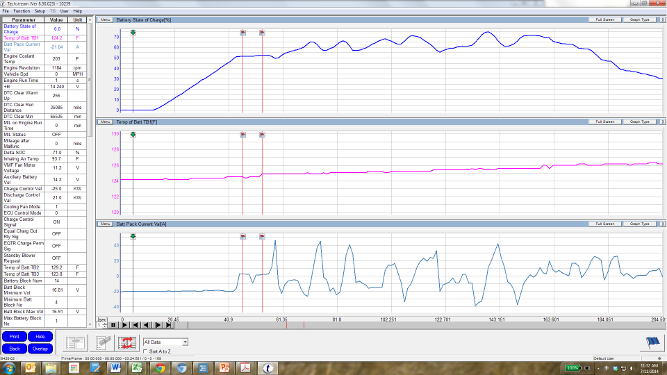

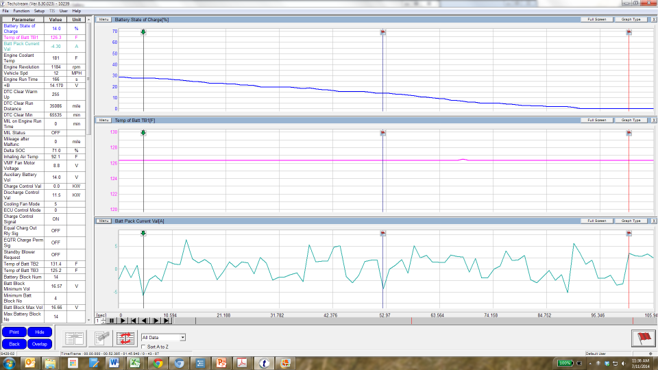

    Attached is another set of screenshots from the same drive showing SOC %, one of the battery temp readings, and battery current. Tomorrow morning I'll try to get a recording from a cold start.

    One other thing you can monitor is the maximum current that you can get in/out of the battery. After warm-up getting 60 amps in the battery and 100 amps out of the battery should be possible; it definitely sounds like you can't get lots of current out of the battery.
    You may also find a much larger weak/strong voltage difference when requesting lots of battery power, and that may tell you if you have failing modules versus battery sensing/ECU issues.

    • Looking back at my screenshots posted earlier, it looks I was getting ~40A out of the battery with in-city driving (if I am reading that correctly, might have +/- reversed and/or might be looking at the wrong data).
    • Modules look pretty balanced to me—difference between max/min is between 0.1-0.2V including under discharge (in R with foot on brake).
