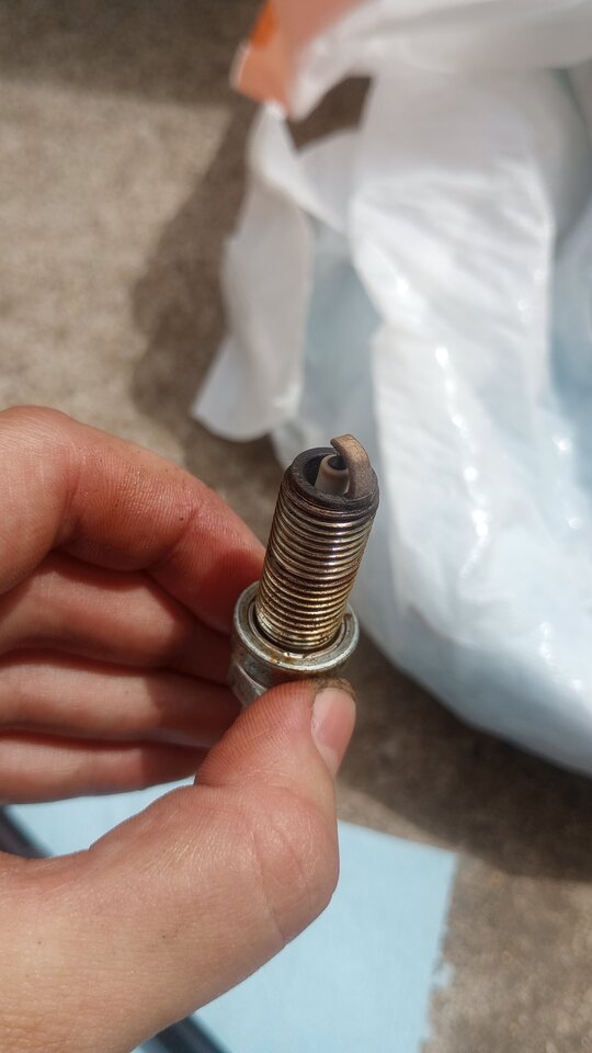

    As shown in the images below, do you think these spark plugs need replacement? They were oily when I took them out, so I suspect piston ring issues. IMG_20260712_145736213.jpg IMG_20260712_145748306.jpg IMG_20260712_145755261.jpg IMG_20260712_145800068.jpg IMG_20260712_145804800.jpg

    You need to examine the tips, electrodes and gap. Any damage or pitting, they should be replaced. Iridium plugs will easily go 100+K miles.

    How many miles have you driven the car using those spark plugs? They look like new.

    I suspect mine might have piston ring issues and I wanted to make sure there spark plugs were not fouled by oil. I'm pretty sure they look normal.
