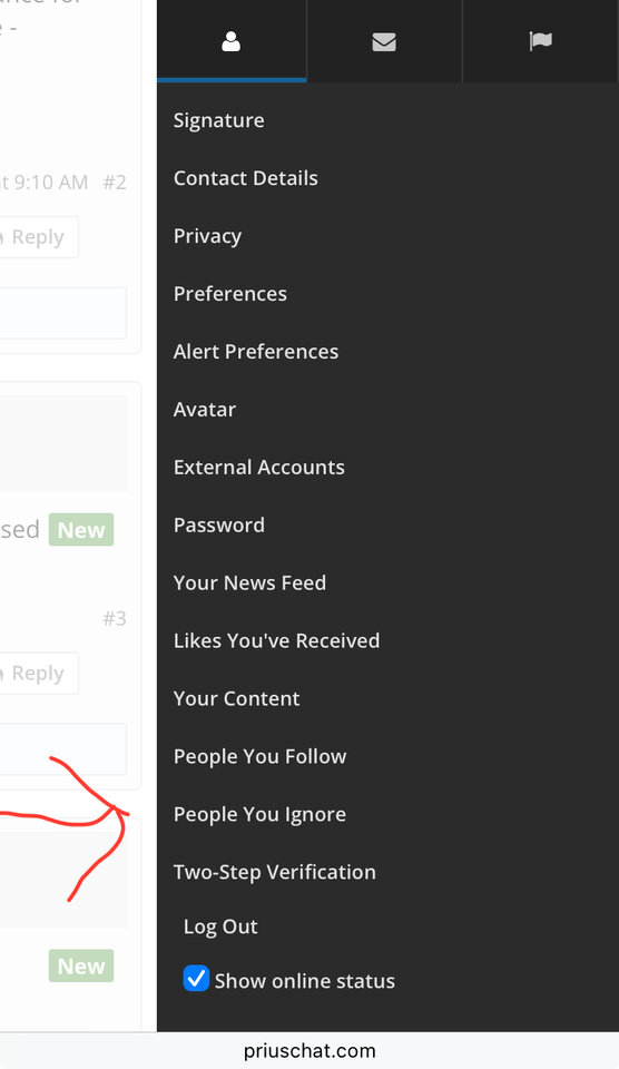

  8. Mendel Leisk
    61,526
    42,341
    On a phone anyway, I tapped on my avatar (top/right corner of page), in the dropdown tapped “people you ignore”:

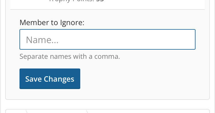

    then entered the member name here:

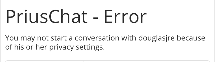

    I was going to private message you, but encountered this:

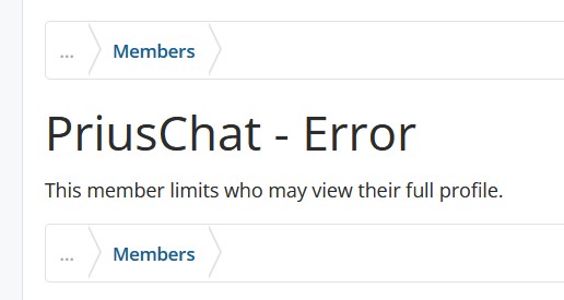

    From the laptop browser view, douglasjre has the exact same profile setting that he complains about for someone else in post #6:
