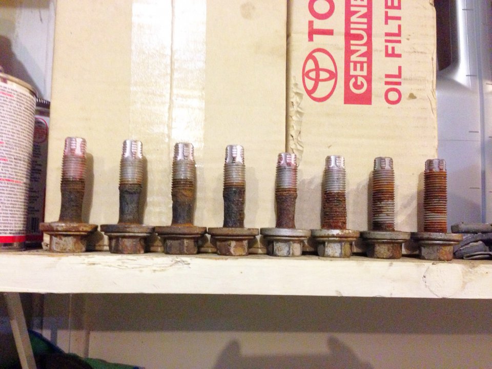

    The touring suspension is a great modification and worth the extra effort, replaced all of our Prius carriage bolts on the front lower as I seen corrosion problem with it. Picture of all bolts attached. The two 2004 were worst followed by the 2006 and the 2009 was not bad at all.

    All 4 of my prius bolts.

    Oh man, that really sucks.....

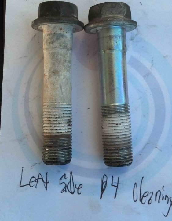

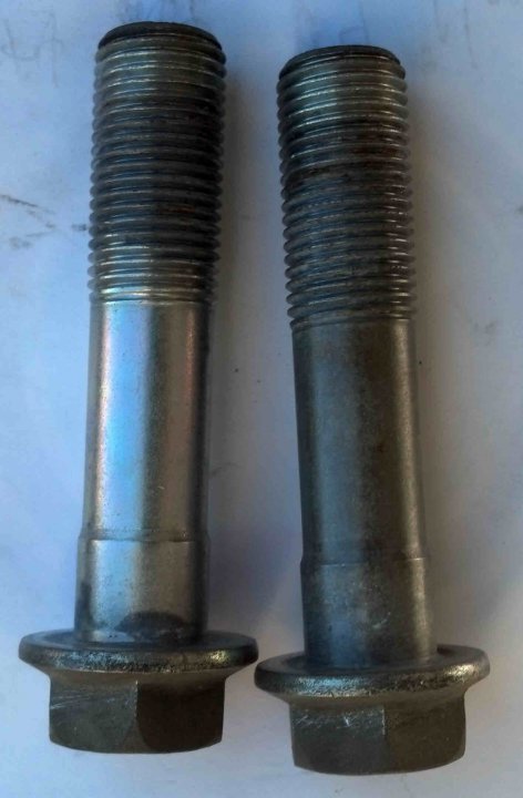

    Left front strut bolts, with lack of the winter salt/snow. Wire brush to scrape off the little oxidation/corrosion, and like new. The rights not pictured, but were identical to the left before and after cleaning.

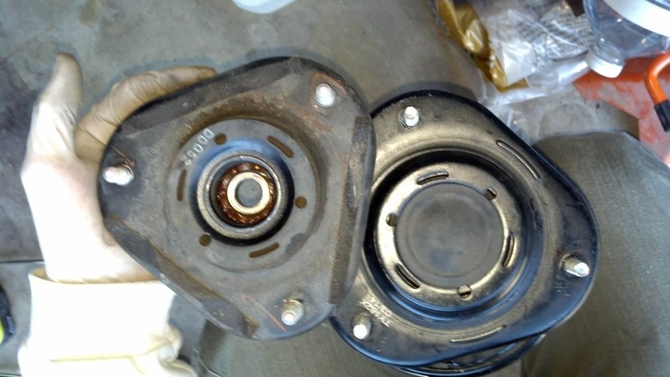

    KYB front strut mounts (SM5215, $55 at Amazon) lack the weather stripping of the OEM (48609-13010, $67.31 Left or Right, at Camelback). Cheap work around is weather stripping available at your hardware store. The three bolts that are supplied with the KYB mounts are little different (13mm or 1/2 inch) vs OEM (12mm). The OEM bolts fit onto the KYB mount.
