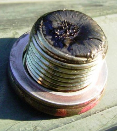

    Starting with the Gen III, Toyota no longer provides a magnetic drain plug, and there is likely a lot of steel and iron particles worn off of the gears in the fluid.
    I've attached a photo of a Gen II drain plug taken out after 100k miles.
    Even with the little ceramic magnet, there is a lot of iron and steel.

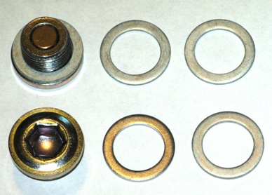

    When I changed mu fluid at 13k, I replaces the standard drain plug with my custom milled OE one fitted with a rare earth neodymium magnet.

    I made them, because I wanted one, and $20 is worth the price. It's cheap insurance.

    Having the magnet in direct contact with the fluid is the only way to get it to work correctly.
    Since the available magnets are larger then the diameter of the OE plug's cavity, the plug must be precisely milled to the correct diameter and "glued" into the socket with a two part epoxy or a special green Loctite sleeve and bearing holding compound like 640.
